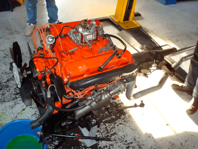

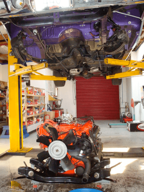

Got some pictures? The suspension does look kinda weird when under no load - and it can appear out of whack.
This is how mine looked the last time I had my engine out for some minor work;
I leave the A arms attached along with the shocks. Disconnect the tie rods and sway bar plus the front strut rods.
No need to disconnect more than is necessary. :thumbsup:
