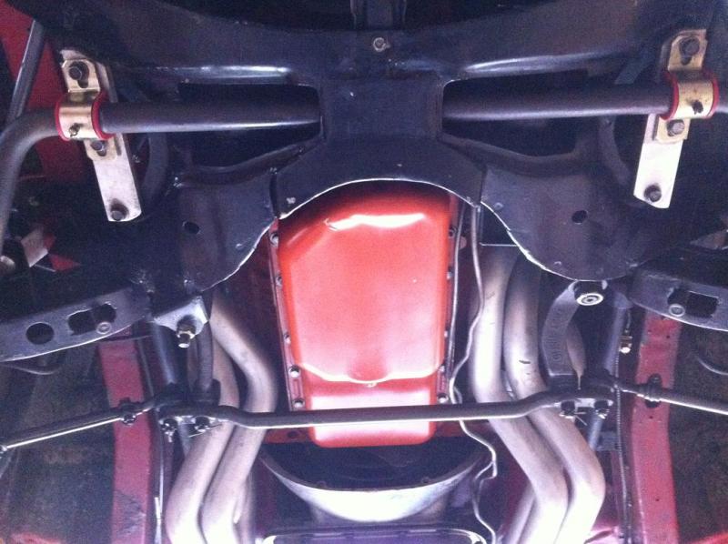

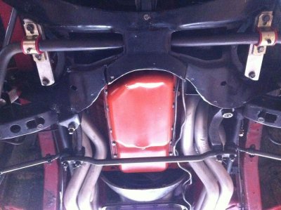

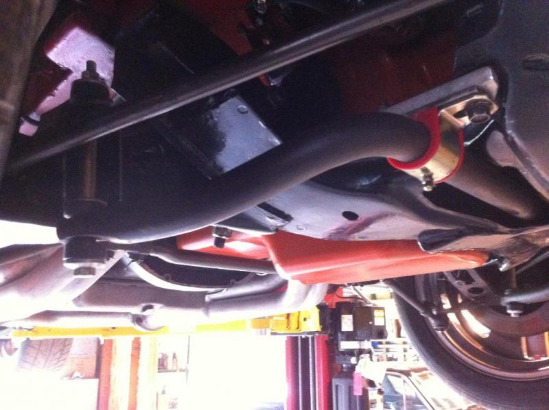

With that said, I have stock based upper and lower control arms, but they are not completely stock. The uppers have Moog offset bushings. The lowers have stiffener plates welded on them. I do not have urethane bushings in either. They transmit too much vibration without much gain in handling. I do have urethane bushings in my stock strut rods.

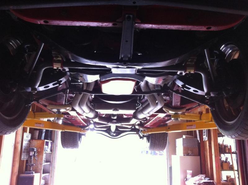

I run 1.15 torsion bars, Bilstein shocks and a 1.25 front sway bar. These would be a poor choice for a drag race car but they flat out work for me. I also welded in 3x3 frame connectors and torque boxes. I have Mopar Performance HD leaf springs, Bilstein shocks and a 3/4" sway bar. I run an 8.75 axle with 3.55 gears and a Sure Grip. People will say the torsion bar size I run is too much, that it must ride like a brick. It actually rides quite nice even with a 275-40-18 front tire, a 295-45-18 rear. Short sidewall, stiff suspension and it still rides about the same as my 2015 Challenger R/T !
