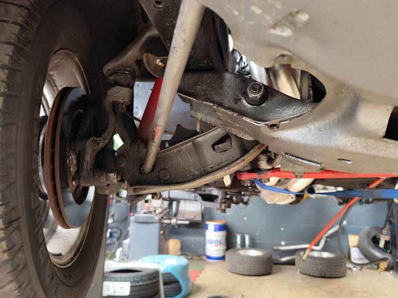

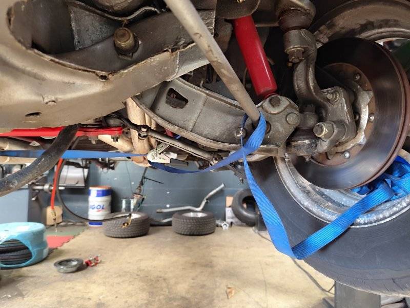

Hello from France everyone
I m looking to get front and rear sway bar for my 71 satellite andi realised m'y lower control arme are missing the braket where the sway bar is supposed to go.
Did anyone have this issue before?
Is there a full kit that comes with the proper bracket to weld?
I tried to look on the internet but i cant find any lower control arms aside from overpriced qa1
Have a good day
Most aftermarket kits come with a L-shaped bracket that can be bolted or welded on.

There is also PST[ one of our sponsors], ADDCO, Hotchkis, BAC[ another one of our sponsors]. If you're handy, you can make your own brackets as I and some other members have done.
My plain '71 Satellite with a 318 did not come from the factory with a front sway bar.
71-74 B body front sway bars clamp to the strut rod.
They do not have LCA tabs.
73-74's clamp to the strut rod. 71-72 is the same setup as a 70 and do have LCA tabs.
Hmmm, let me check my 72.
I was almost certain it was clamped.
