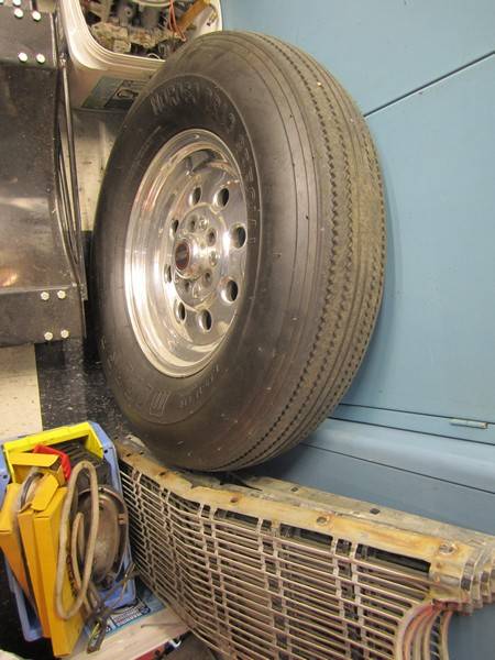

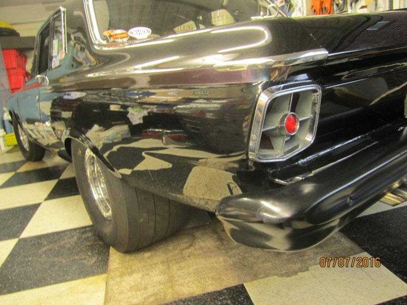

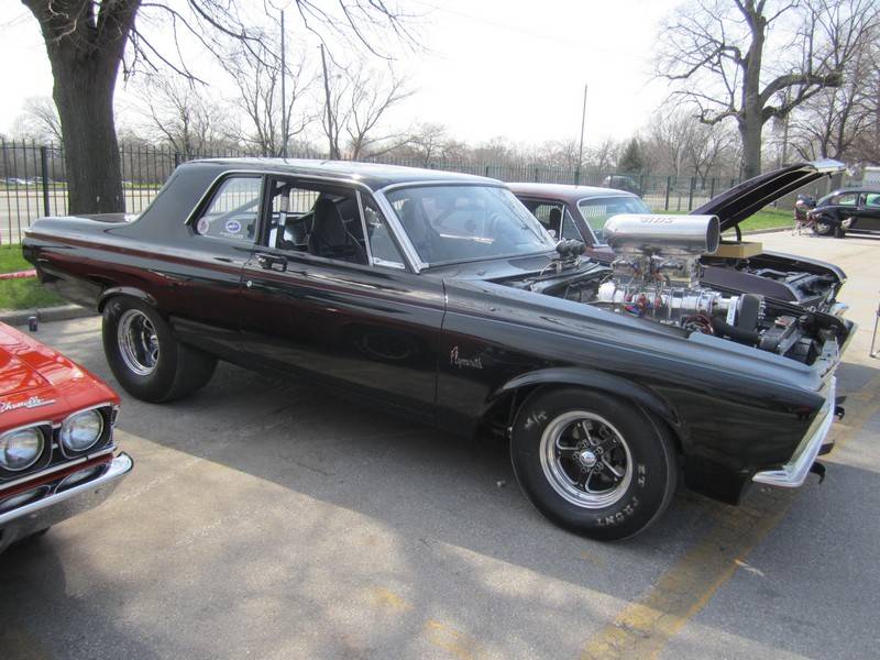

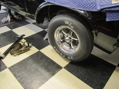

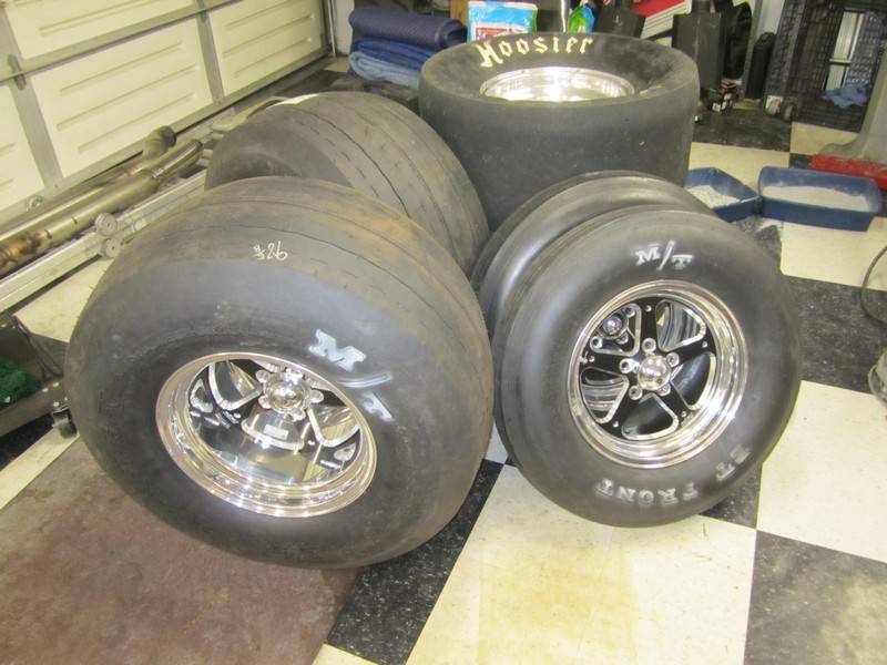

What are driving needs? If a street car 4" seems very narrow, if a mainly drag car I used both the 27" and 24" Moroso fronts, drag use only. For drag use need to decide what works for you.

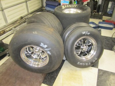

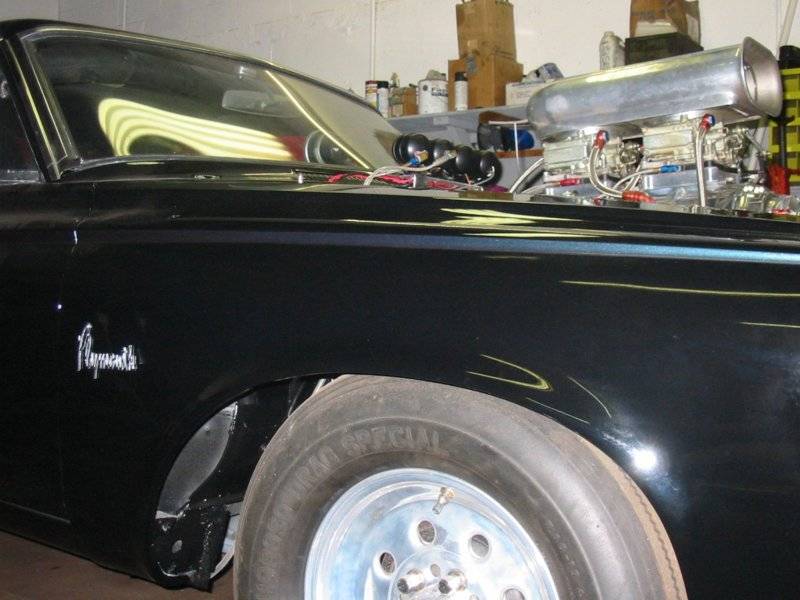

Bf Goodrich silvertowns 7.10x15 is what I use if you don’t mind bias. About 28” tall I think.

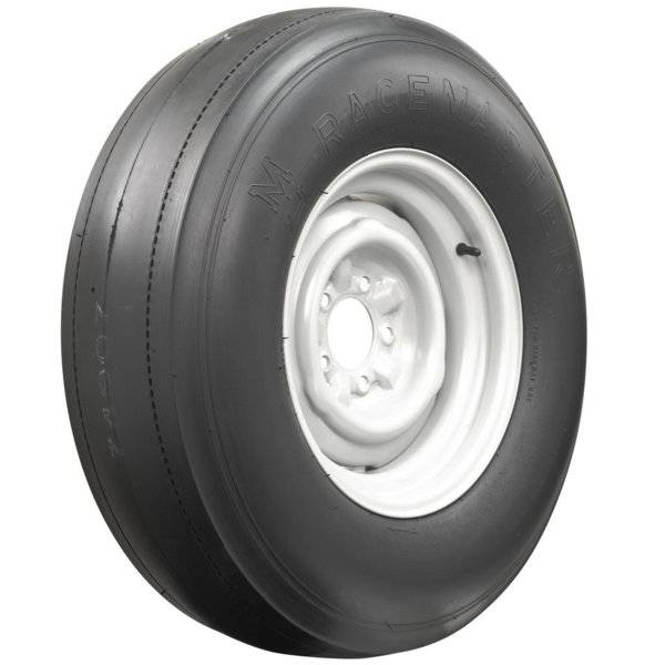

Yes, take a look at these. I put something similar on my 63 and bought Coker brand through Summit. Very period correct look.
Street car only. That 7.10 Coker fit ok on 4.5 wide front wheel ?
7.10 will fit well on a 4.5 front runner. its tall so there will be a lot of tire flex when turning but these things aren't track cars. its worth the cool look

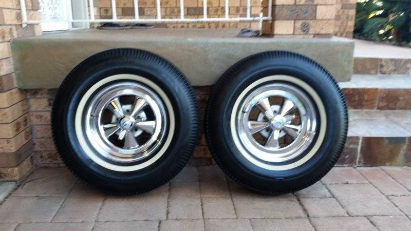

BFG silver towns on a 4.5" rim...around 28-29" tall

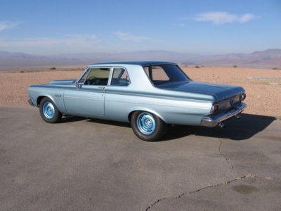

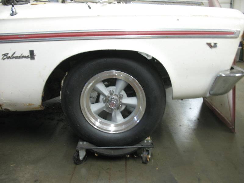

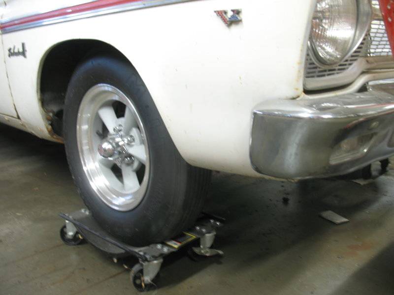

I run these standard tires on the front of my 63 on 15 x 6 Torque Thrust. The tires are 215/70-15's. Ron
Here is a side shot to show a better shot of how they fit the car. Ron

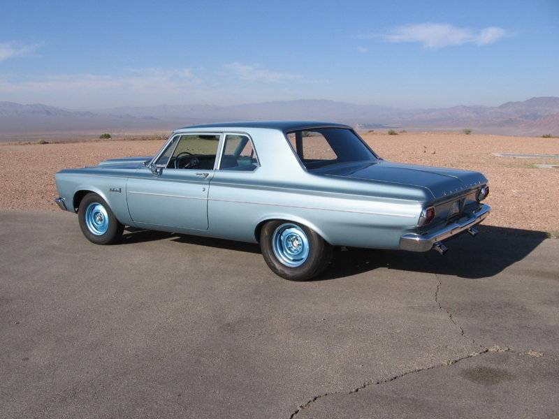

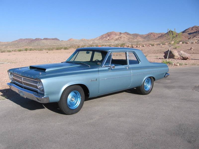

215/75R/15 27'' tall Hercules about 70 bucks. 6'' steelies. The blue color is different than the car. Just put them on to check fit.Repaint later.
It's Sonny's fault. You got me hooked on the steelies look.275/60R/15 rears on 7''.Lowered the back,raised the front like 1965 again.
