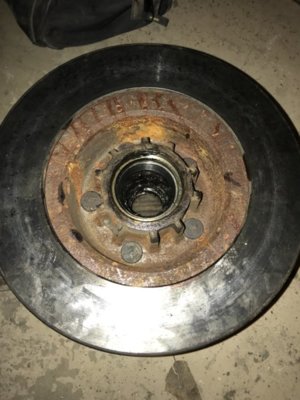

Folks,
I have had a drive-line noise that bothered me all last summer. Sure enough, the Chinese wheel bearings in my front disc brake converted Coronet are pretty crunchy, when I finally took everything apart. The conversion had already been done before I got the car, and am somewhat unfamiliar with them.
The outer bearing is chewed up more than the inner, so that will be swapped for sure. Question is: is the inner bearing supposed to be pressed into the brake rotor? I was basically able to peal it out of the rotor by hand, and felt VERY sloppy before I did so. Is there a race, or something similar that may be toast in the rotor as well?
Thanks in advance. Tyler
I would replace all the bearings with quality ones. ( Timken). The outer races should be tight in the rotor, and the inners should push easily onto the spindle without any slop. The bearings need to be adjusted with the nut on the end of the spindle, so get a service manual if you don't have one.

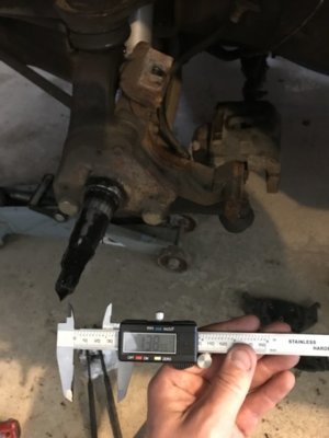

Some kits use the drum spindle, and some use 73 and up disc spindle, which take different inner bearings but the same outers. If you can get the numbers, that would be good. If not, measure the inner bearing diameter on the spindle. If it is 1 3/8 then order bearings for a 73 up Dart or valiant . If 1 1/4 then order 62 to 72 B body bearings. There may be some odd kits out there, so bearing numbers are the best way to get what you need.

Ok. I assume you are referring to the inside diameter of the bearing? i.e. the diameter of the spindle shaft?

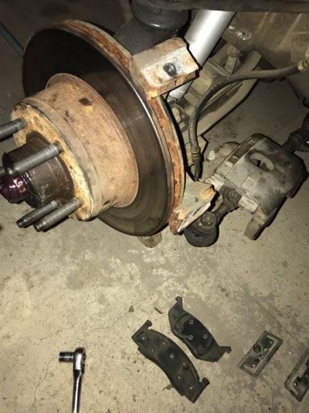

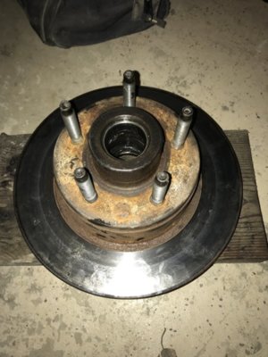

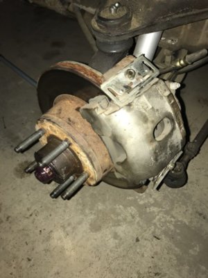

Thanks for the link. Again... sorry for asking remedial questions; but after reading the article, I am wondering what era of hardware I have? I do not have the "slide type" caliper set up, where the caliper housing physically bolts to its bracket. My single piston caliper sits on top of the bracket, with the flat "spring steel" pieces to hold it down. Though I haven't looked real hard... but I have yet to research a conversion kit with this type of set up. These parts may have been robbed from a late model at some point?
Sounds like 73 and up slider calipers. Very common. A lot of conversions use this type. They were installed on A bodies, F bodies and most everything else except some B bodies. Pictures would be nice.

1 3/8'' spindle diameter

Looks like the old disc-o-tech conversion
Search allpar.com for disc o tech
I believe you will have all of your answers to parts
1976 aspen will work for you. Bearings, calipers, pads, and if the rotors are aprox. 11", then rotors too. If the rotors are 11 3/4" then 78 cordoba rotors are what you need. All the other parts I mentioned will work with the big rotors. This is just for future reference.
