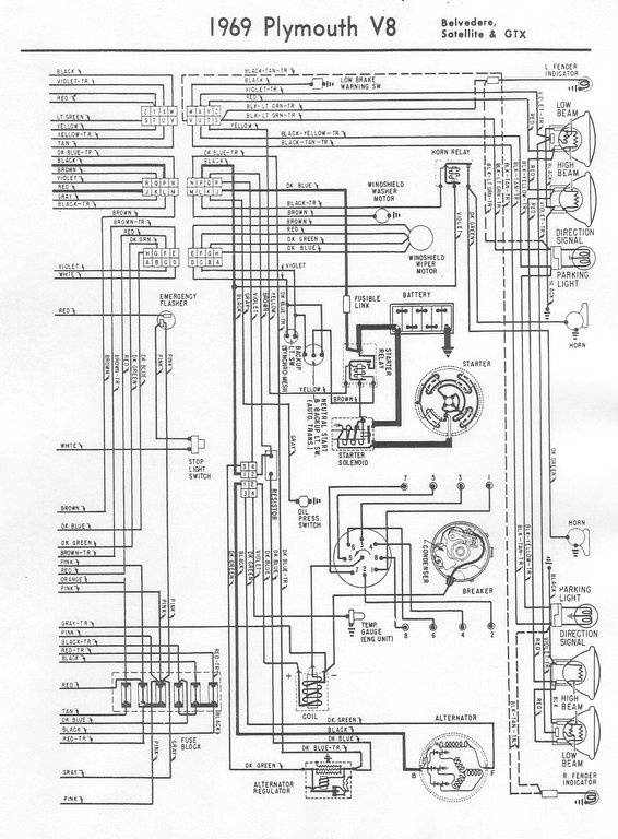

69 roadrunner,i have been looking in fsm for bulkhead info on the eng harness plug and i do not see a explanantion of the letters on that plug i was looking to see what letters m,n,p what circuits are they i have burned plug on one of those prongs,is there a page that shows the designation for the letters i do not see one. thanks
It looks like the windshield washer motor and P is the main wire from(black) your alternator. Do you have an over sized alternator and have you done the Mad Electrical bypass?
On a 68 it's: m-brown from washer sw to washer pump. N-ign1(dark blue) to ign side of volt reg. P- blk batt feed off alt to a junction probably to ammeter.
maybe blow these up a bit & trace them back
i will send cluster out to redline guages and have volt system put on with factory amp face. i have 60 amp alternator.
