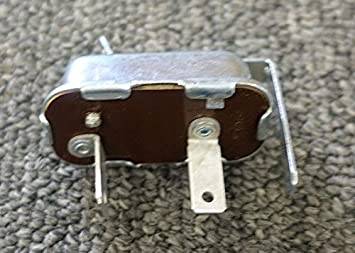

Dunno which VL gets the 67 Coronet but on this VL, the input is the middle prong, and the ouput is the left one

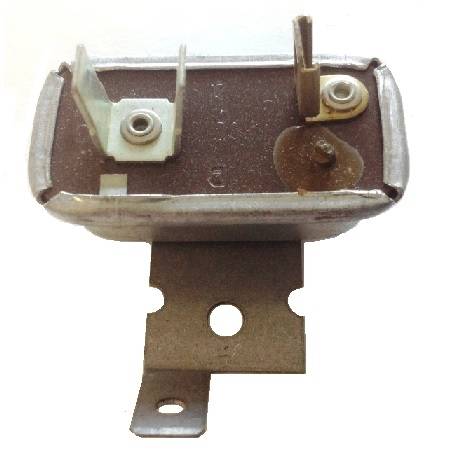

On this one, The input prong is the U shaped, and the output is the one alone ( female )

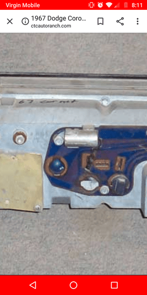

Upper limiter is in 67.
Thank you for the very valuable Info. I have the first voltage limiter and it has a condenser shaped plug that feeds into the middle prong I have no idea what it is but I'll try to find a picture
