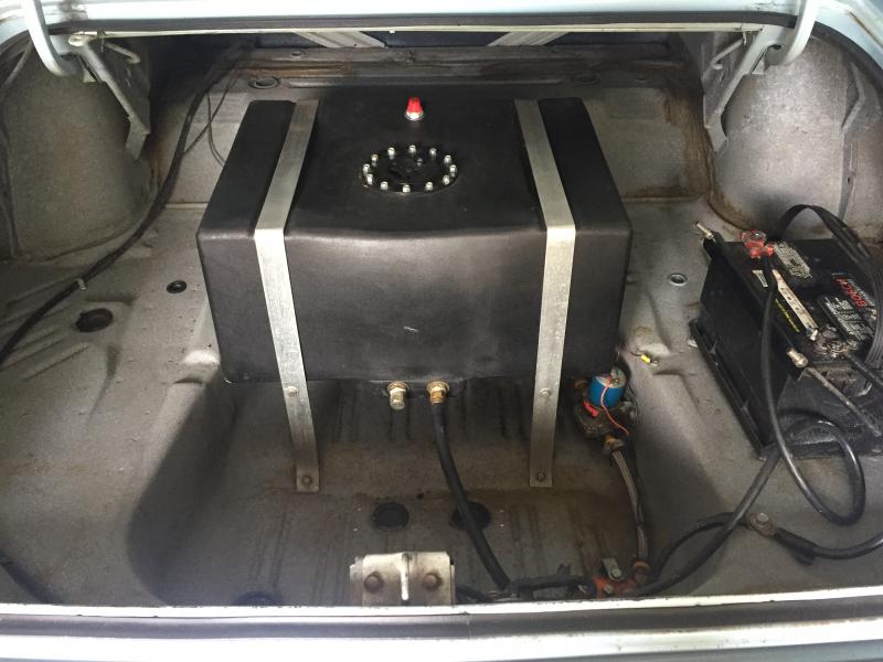

My 66 has moved springs and the fuel cell set up like this. Don't know if its good or bad this way.
Nice setup, I am also doing what you have done and install the battery in the back.

Claw, really like your setup. where are you grounding the battery?
Claw, really like your setup. where are you grounding the battery?[/QUOTE]
Thanks Slink. I bought the car set up like this. It's grounded in the bottom right of the for photo to the frame rail . I don't think is enough though because cranks real slow.
I need to do the same relocation. You may need to add another heavy duty ground (like 1/0 cable or 2 gauge) from the engine block to the front frame rail or suitable chassis ground to get it to crank stronger. I have found our cars love grounds to the block, more the better.

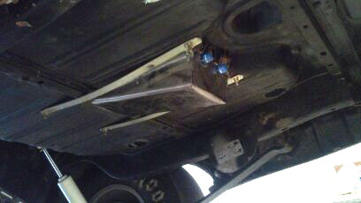

Kingzj, If you mount the tank flush to the trunk pan with the sump extending outside below the trunk pan and you go to the track, you should have a metal protective shield covering the sump of the fuel cell. It's in the rule book and depending on the tech at the track, you might not pass tech. It just depends on the track.

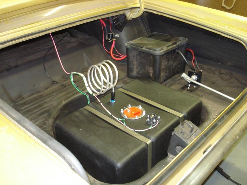

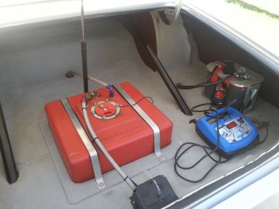

At the chassis shop in 2005-2006? Used a translucent/10-gal cell. It now has a 16-gal aluminum cell in it's place.
...and after getting it wired and adding more componants.
Wow very nice and clean looking on both cars. I have some good ideas now. Now to find a cell I like.

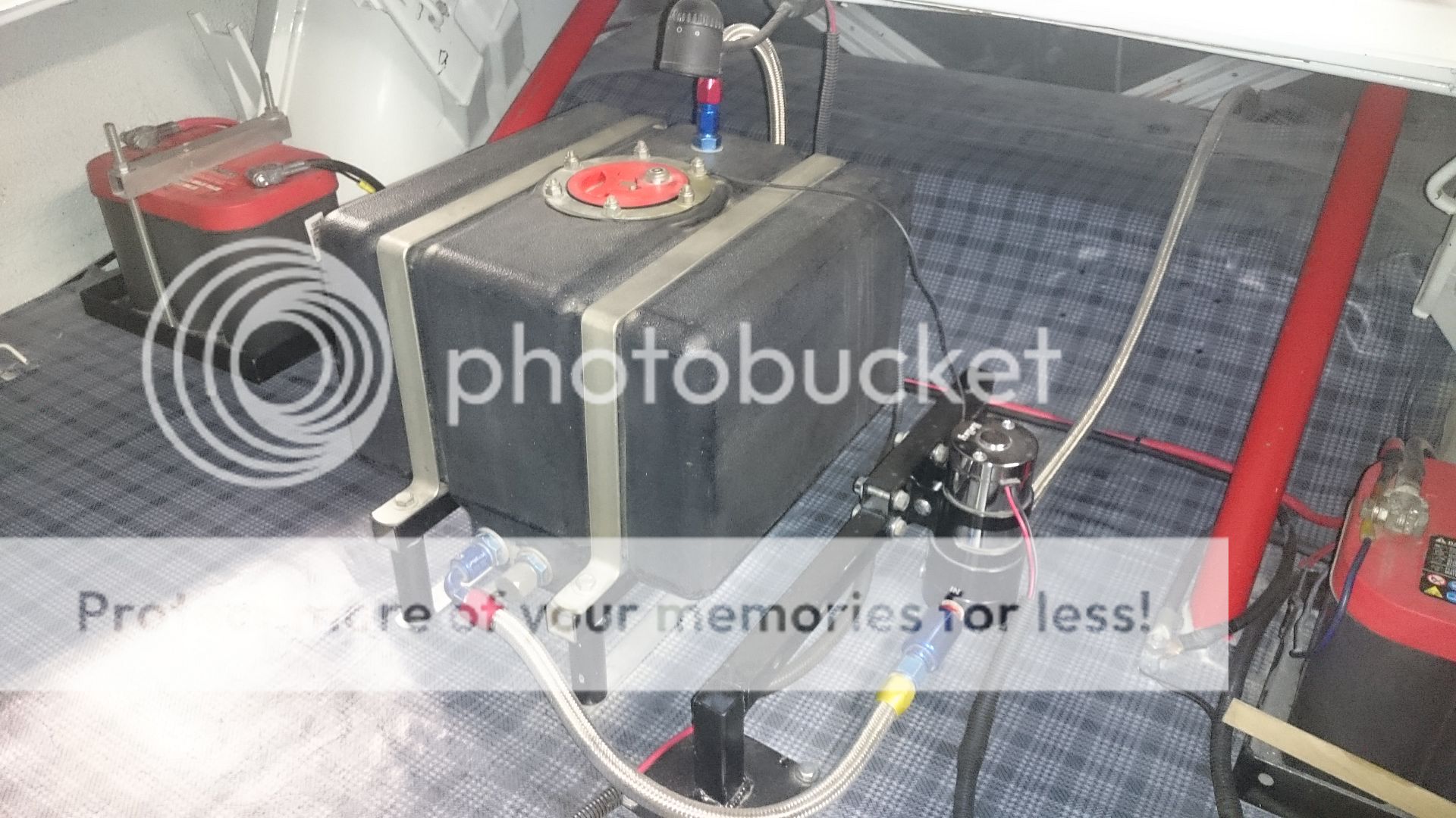

Here's a picture of what I did, I believe this was a 15 gal fuel cell... Did this last year with the intention of having it on the street, explaining the huge tank and the gas gauge sending unit. Its hooked up to a frame I made and welded to the body.
Mine looks kinda like that. Seemed like the most solid mounting system.

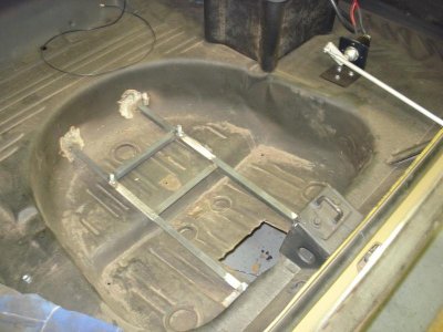

My set-up is a bit different because I didn't retain the stock trunk pan when I built my car...the floors and trunk were both rusted beyond repair. I put a stock floor pan in it, but decided to just sheet metal the trunk. I decided to use a 5 gal cell..since I top off the fuel after every run so to keep the weight consistent.... I seen no reason to use a big cell.
[/URL][/IMG]
I used a large cell, because mine occasionally sees street use.
In hind sight I wish I would have just installed sheet metal to my trunk floor, it would have saved a ton of work and money.
