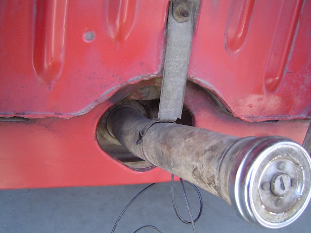

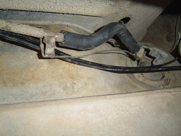

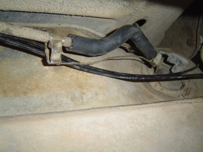

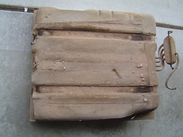

Would anyone happen to have a picture and measurements for a fuel filler neck for a 73 satellite? The car I'm working on doesn't have a fuel tank or any of the associated parts and I'm trying to round up all the parts to put a tank back in it.
The neck is 17.25" in length, here are some photos of the tank, fuel neck, pickup and vapor seperator. Hope this helps!!!

Thanks! Those pictures are a great help. I have found the tank, sending unit, straps, and neck. I haven't looked yet, but I assume when the tank was removed they probably took the vapor separator out with it so I will probably be looking for that next. Dang it
