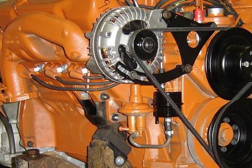

Does the fuel filter on my '73 Charger w/440 engine install on the inlet line to the fuel pump or on the exit line to the Carter Thermoquad? Any pictures would be great as someone rigged the lines I have and I'm trying to correct it back to it was from the factory. A recommeded source for pre-bent fuel lines for same car would be appreciated.
Underneath the alt as soon the gas line leaves the pum. Vertical position
Not exactly filter for 73 but still 71 B body, so, same configuration… you get the idea.
On this pic the bottom line looks a bit diff than the one posted from eBay but we must consider that filter gets the nipples offset, while on 73 the filter is smaller and with centered nipples, so the gas lines will align
