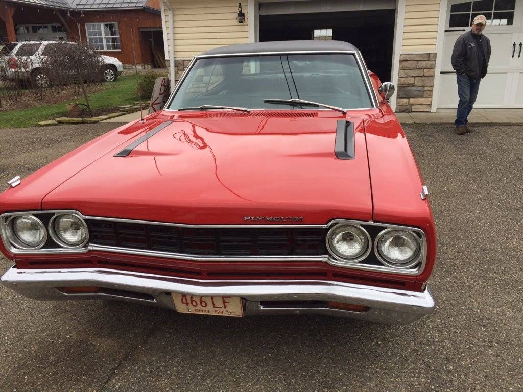

Need some input. I have 1968 Satellite converted to 440 RoadRunner Clone. Car has new fuel tank and sending unit in gas tank. Wires from sending unit to fuel gauge checked and find to be good. Only owned the car few month. Original owner who did conversion said the gauge was working. Other than something being wrong with the gauge, any suggestion on what I may do to fix the issue. Really not crazy driving around with not fuel gauge.
Appreciate any input on this issue.
