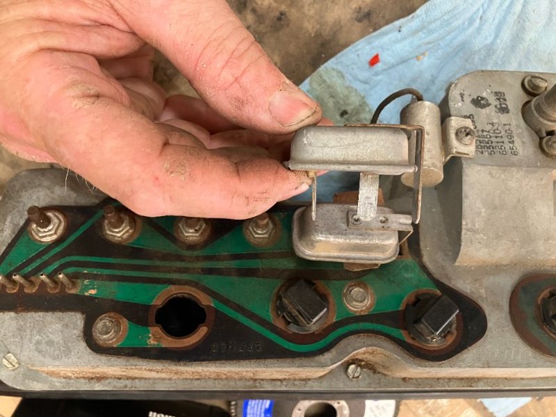

If the needle stays still, the problem could be in the dash itself. There is a voltage limiter pressed into the back side of the instrument panel...
I'm no electrical expert either but these do go bad, cutting power to the fuel gauge.

The voltage limiter controls both the temperature and fuel gauge in 1967. If the temperature gauge is working and the fuel gauge is not, it's not the voltage limiter. As stated above test the fuel gauge.

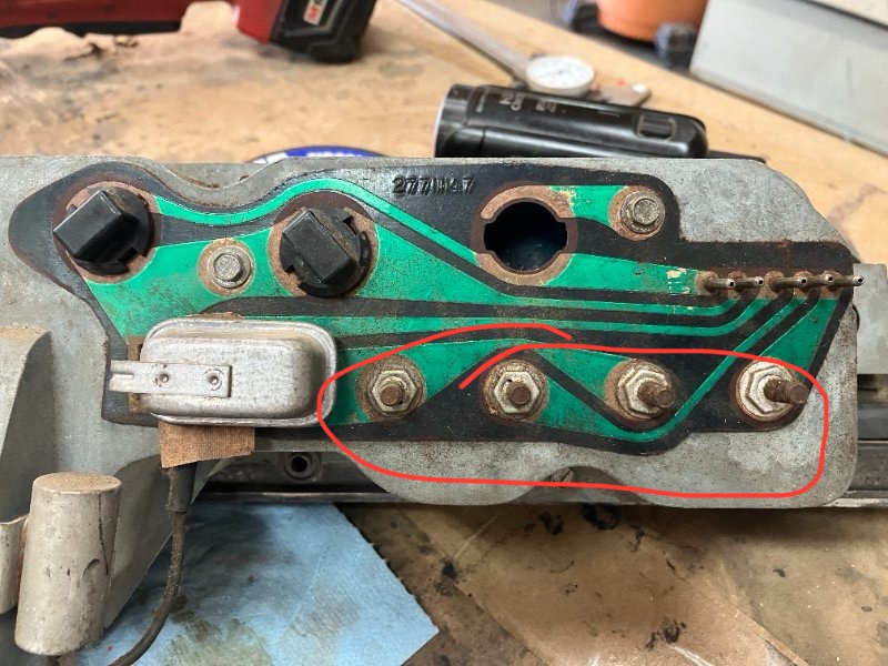

If the gauge doesn’t work with the above test, I would loosen and re-tighten the nuts on the back of the dash circuit board. Just couple of turns each way - no need to remove. I took Keen Dog’s picture and circled the nuts where the fuel and temp gauge connect. There could be some corrosion preventing the electrical connection.
