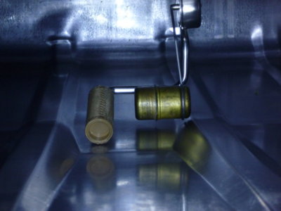

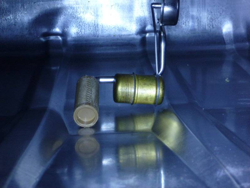

Did you check how it sat when IN the tank (looking through filler neck hole) and then the other idea (that I never thought to do), measure the "height" of the float swing vs the tank so you know it's not hitting the top of the tank before the rheostat covers it's full travel. Pictures to show how mine went in out of the box (float cocked) and after adjustment to sit and swing parallel to the tank bottom.
I ASSUME grounding the sender wire gives you a full tank reading?

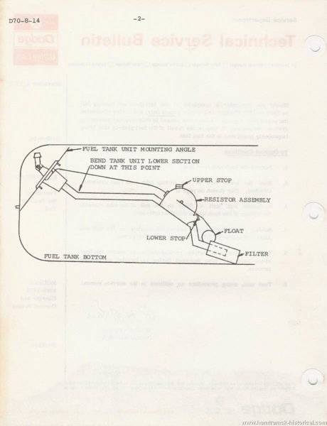

Check out this TSB from LONG ago:
In my Charger, I had the same sort of problem for 13 years but just compensated for it. A tank with gas spilling over the neck still never read MORE than 5/8 full. 3 years ago I installed new gauges and decided to see if I could correct it. The TSB picture to the right was a big help. My fuel pickup was about an inch off of the floor and the sender and barrel/float was even higher. I bent the entire assembly as shown in the picture and it now reads correct at full and empty. That was helpful...BUT because it is an aftermarket sender, it is not as accurate as a stock unit in between full and empty. Stock units were not linear, in other words the ohms reading at a half tank was not a number half of full. The new senders are. The aftermarket vendors so far have not made a sender to match the odd elliptical ohm curve that stock sending units use.
