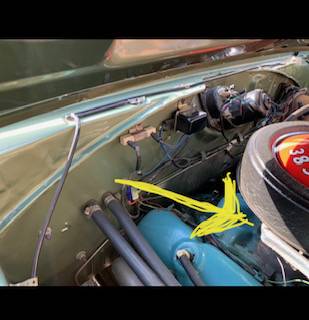

Has anyone ever see or know where to get one of these fuel line insulator socks?
this is on an original one owner 68 roadrunner....
I have never seen one and I really doubt that is original. More than likely someones vapor lock cure.
The other answer is to add. a return line and a factory vapor separator next to the fuel pump.
The car may be original, but the fuel line covering has been added on.
