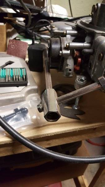

On my fuel line pictured (holley 750). What is the twchnical name of the inlet piece Im missing? The piece I bought was to small..Im not even sure the brand of the fuel line, it was already on the carb...
What you show in the picture appears to be this part: Holley Fuel Lines 34-150
Summit racing: https://www.summitracing.com/parts/hly-34-150/overview/
The correct inlet fitting if you are connecting a hose to it would be: https://www.summitracing.com/parts/hly-34-22/overview/
There are options available elsewhere for a straight line rather than 90 degree. This is a simple inverted flare fitting with hard line shown in the link above. I see you have what looks like an AN fitting in the package in your picture. Do you know if your double feed line accepts an AN fitting or an inverted flare fitting?
I could be way off here....maybe rumcustom is correct if it has a special inverted flare fitting or something inside (can't see it), but you might be just fine with a brass 3/8" hose nipple with the correct male threads on it from a hardware store (& teflon on the threads). aka - "hose barb" or "hose nipple"
Need to take a look inside the inlet to see if pipe thread or flare. Pipe thread is tapered; inverted flare is straight thread with a "nipple" in the middle where the flare seats. The "Suggested Parts" tab in the Summitracing link for the fuel line shows that it would be inverted flare for THAT one.
