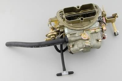

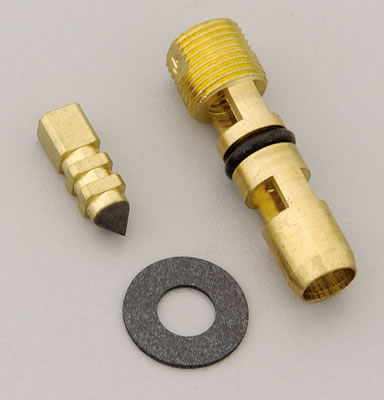

Depends on what type of Needle & seats your using
But "generally speaking" a Holley Carb like a 2300 2bbl or DBL pumper
either with a normal material stock type "Center Pivot style of Needle & Seat"
controlling your fuel bowls float levels
will handle about 7 psi {+ or - a 1/2 psi} with relatively no issues,
too much more that that you could have issues...
