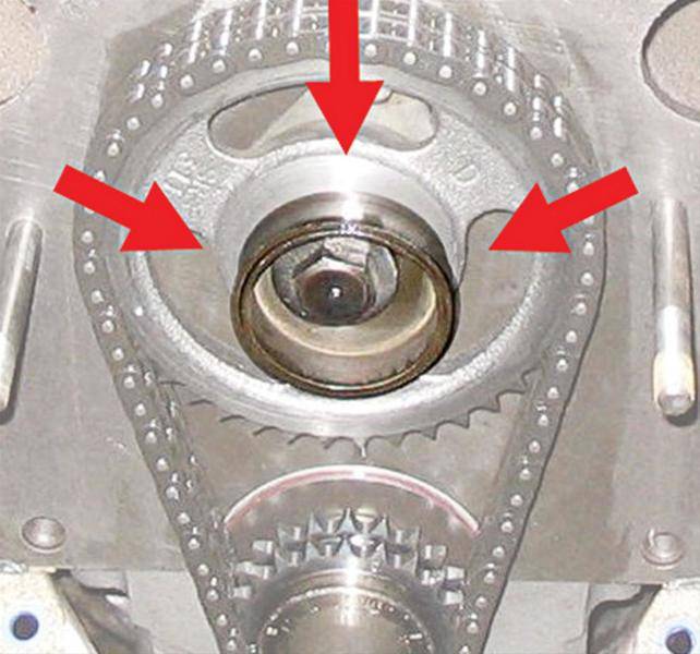

I took my sons timing cover off of his 1974 charger with 360. Actually 408 striker after the eccentric sheared off the woodruff key. The only pic I found shows the button washer with the dome facing out. The machine shop installed it with the dome towards the cam? Which is correct? Thanks
The dome facing out like the picture shows. 440'
Thanks. I am glad I didn't just put it back together the way they had it. Wondering if that's why it sheared off the end of the woodruff key? Also noticed the eccentric was cutting a good groove in the timing cover. Good thing it quit when it did
