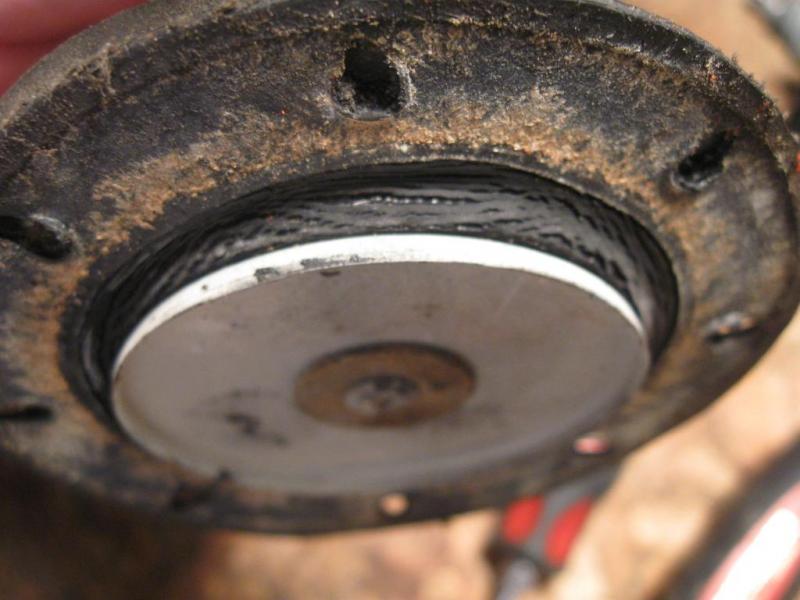

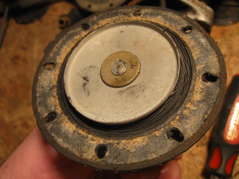

Car would't run unless the carb was full of fuel. After some trouble shooting narrowed it down to the pump. Its a mechanical Carter rebuild able one.
I pulled it a part and sure enough the diaphram is cracked.

Wow! More importantly, look a that receipt!!! I know kids older then that receipt! Anyway. I would upgrade and just for the fun of it.. I would look at that fuel pump pushrod and make sure it hasn't mushroomed in there.

Got a rebuilt kit from Mancini yesterday. None of the holes in the new diaphragm line up with the pump cover and body. Then the metal backing plate for the diaphragm is too big and wont fit into the lower half of the pump body. Not impressed.
I would just send the parts back and replace the entire pump.you definitely got 39 bucks worth out of that one. that is almost the cost of a stock replacement these days

That's the plan, just a little ticked. Weather is supposed to in the 70's this weekend and would like to get the car home. Oh well.
