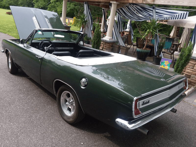

My 1967 Barracuda had a big gas smell (which I love by the way). I removed the tank and found that it had a crack on its top, that I never would have found if I didn’t remove it. It’s great that you found your issue so quickly!
