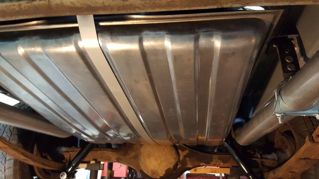

I'm putting a new fuel tank in this weekend. It's bare metal right now, and I'm wondering if I should paint it first? I watched the Graveyard Carz folks install a new one on a Challenger recently, and they put it in unpainted, and can't help but think painting it would be the better way to go.
Do you guys paint new tanks or put them in without paint?

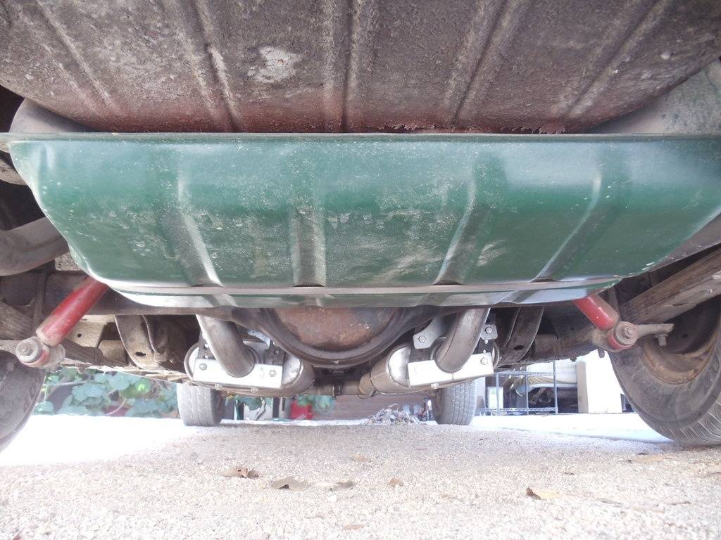

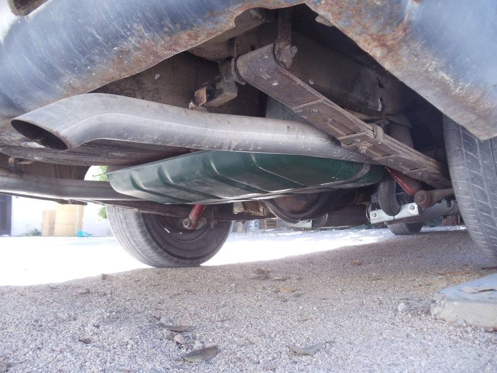

I cleaned off whatever that waxy coating my new tank had and then used Rustoleum red primer followed by Rustoleum color coat (looks like John Deere green-just to be different). Ten years later it still looks great. My "policy" is to make sure every part of my restoration has some kind of personal touch.

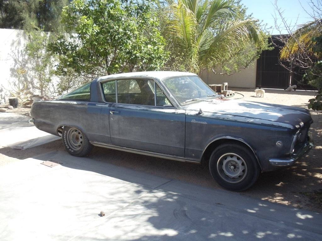

The green painted fuel tank is on my '65 Barracuda Formula S which is still in a kind of "rat rod " looking mix of original factory white and a gray primer after ten years. I will post a foto here.

Bruzilla, if your new tank is a Spectra it should be weather proof. It may look like bare metal, but it is ni-terne coated. Which means that it was given a flash coat of electroplate nickel, then a tin/lead alloy dip just like the original.

It is a Spectra, and thanks for the information. I am painting the underside of it as it is easy to see since my car is WAY up in the back. :)
