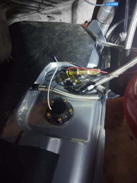

My fuel gauge with the sending unit now is showing ¼ when the tank is close to full. It looks like the sending unit is in upside down, but it will only go in one way. Should the wire stud be on the driver side or the passenger side? Or maybe one of you guys have a part # I can compare it too.

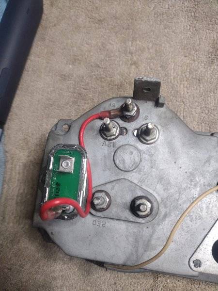

Mine reads the exact same thing. Original rebuilt gauge and a newer sender. I’ll be looking in to the Vans sender too haha.

What really sucks is that the sending unit works when I test it outside the tank, it will bring the gauge up to 3/4. It seems like its upside down when its installed, but it only goes in one way.:wtf:

I tried to bend the one that was in the car. It does test ok outside the tank, if I hold it the opposite way it belongs in the tank, then the gauge will go to 3/4. I'm thinking it's just the wrong sending unit the guy before me put in.
People on here have said it’s something to do with the signal from the sender. Linear vs nonlinear. Mine tests fine too, it’s just something about how they talk together.
