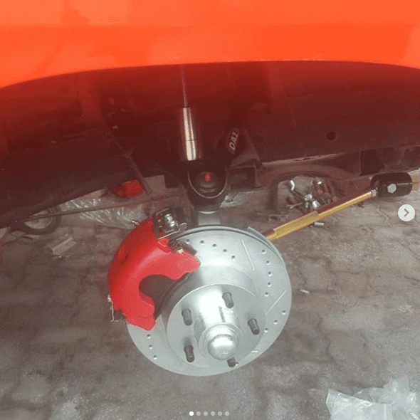

Hello, thanks guys for giving me some info about brakes and suspension.
So the shipment finally came. I've installed the brake kit front/rear + the QA1 suspension for both front/rear
