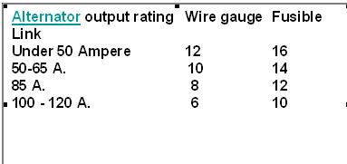

Found this on Allpar.com
Alternator output rating Wire gauge Fusible Link
Under 50 Ampere 12 16
50-65 A. 10 14
85 A. 8 12
100 - 120 A. 6 10
Lets try this again
