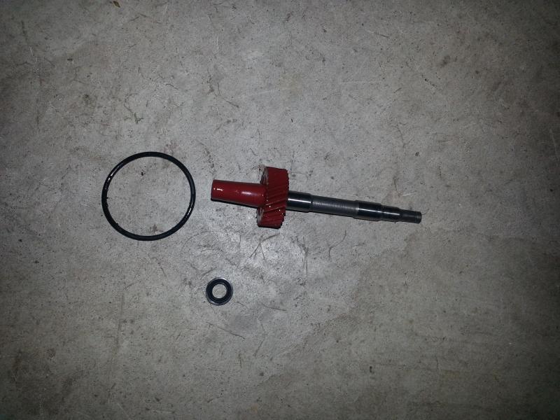

Hey I finally ordered my new speedo gear, a 33 tooth yellow one and I also ordered the gaskets (o-ring and small rubber ring). My old one was a 27 tooth gear, after some calculations i found that it was way off. The o ring is way too big and I'm not sure how the other small rubber piece goes on. Does anyone know how this goes on?
Also I'm in minnesota so Im not going to be drive it around in the snow to test it. Can I just keep the rear end jacked up and run the car to see if the speedo needle moves. I don't have a posi. Can it run if all the fluid is in the front of the tranny?

Great thanks that really helpful. Another question. My gear I ordered was supposed to be a 33 tooth long sharft and I just got it and it has the number 55 stamped on the plastic end. I thought that this number meant the amount of teeth it has. Anyone know about this?
Okay I found out that its the right gear. Should my speedometer read anything if my car is jacked up at the rear end and I'm just giving it gas? I notice only 1 tire spins but still it should work right?

Should still work with you open (one wheel turning) rear end.
