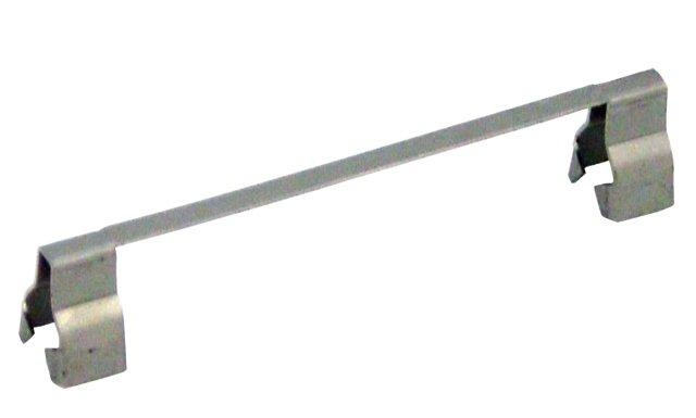

Do you have a ground strap straddling the rubber line from the sending unit to the hard line going to the pump? If not add one, if there is one there try cleaning up the contact surfaces.
