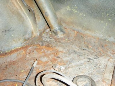

There were two gas tanks. If you had a California spec car it came with a Evaporation Control System (ECS). These cars had a different gas tank. To identify a CA car, look for a vapor liquid separator tube in the trunk.
I don't the P/N for the CA tank though...
Here's a picture of the tube - not great, but hopefully you get the idea. 20111123_1009.jpg
