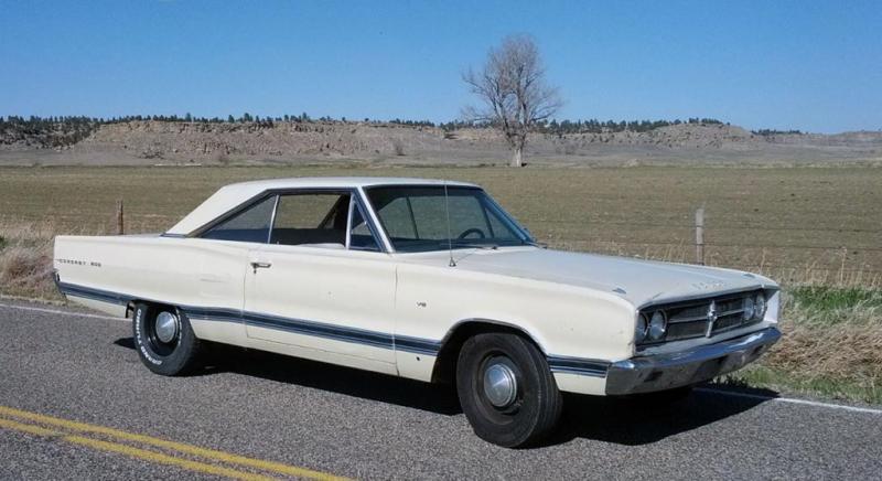

Me and the wifey took the cream puff out for it's virgin voyage since I bought the car and just got the motor running. No plates, a little bit of brakes but what the heck, I just wanted to make a trip to the gas station to fill here up.
Here's a pic...

Is that the car that was on ebay very recently?
If so, you got a great deal!
