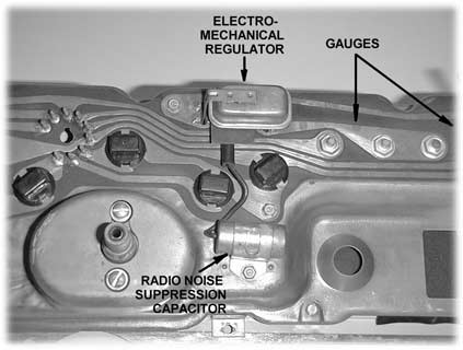

I would check your voltage limiter on the back side of the cluster. Those gauges work off of 5volts. If it goes bad your gauges wont work.top center of the picture below. its a box.
