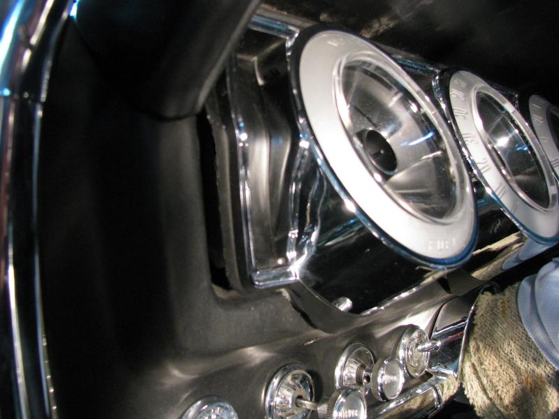

:angryfire: Bad experience with P G Classic Charger Dash Gauge Bezel....
I hope B/E&A don't have the same source for those bezel !
Recently I bought 144-66CH -1966-67 Charger Dash Gauge
Bezel Non/AC
I must say the cosmetic of the part is good,but the fit of the part is not,
After installation of the new Dash Gauge Bezel I realise
the part was not fit deep enough in the dash see attachement I tried to figure out what was the problems (remove and
install many times the bezel) and I do dammage to the bezel ,many
scratches...

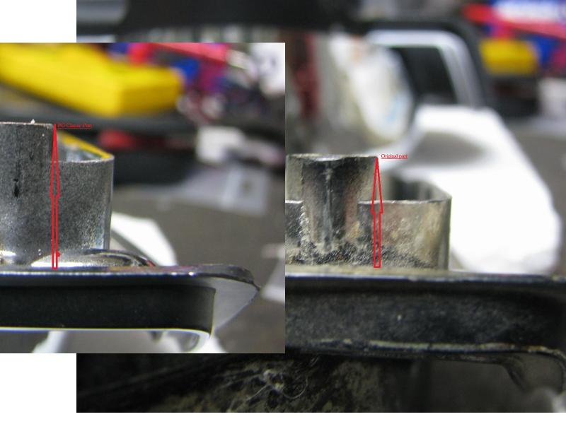

After inspection I found the problem, the back of the
bezel is not like the original more material in the back see attachement.
To fit your part I do a lot of rework on the metal
housing to have a decent fit...
Now the fit is better but the bezel is damage.If the part fit the first time I will not end
with many scratches and dents.
I sended Email to P G Classic never had an answer, :icon_thumbdown:
I suggest to redo your bezel more expensive but not poor chinesse repro bezel...

I purchased my repro bezel from Mike at BEA parts for my 67 restoration project, plus the lenses and it all fits perfectly. Maybe that was just a bad part....I'd definitely get my money back from PG...

I bought the repo bezel and it is a very poor fit. It stands out and the screws don't fit correctly either. I would restore your original. I would never buy the repo again!

Here the answer from PG Classic...
Hello Jacques 144-66CH -1966-67 Charger Dash Gauge Bezel it reproduce since 2006 and has been sold over thousand. in are recodes it fix good. for the classic old car some time when in stall the new parts on it my need some adjust. i see on you pictures look like need to align out a little on right top. when it finish always had few MM space between body.
How this bezel can fix good with this big excess material Poor cheap PG Classicpart...

Bought it from BE&A...it also stood out from the dash just like in strokie's pictures. I also got the "we have sold a bunch and never heard of a problem." My advice is to stay away from the repo part unless they have changed the molds.

HUH???? Nice, at least get a decent interpreter that knows the English language.

Do you have picture of BEA parts after installation as per Charger Pilot answer .. .Bought it from BE&A...it also stood out from the dash just like in strokie's pictures. I also got the "we have sold a bunch and never heard of a problem." My advice is to stay away from the repo part unless they have changed the molds.
