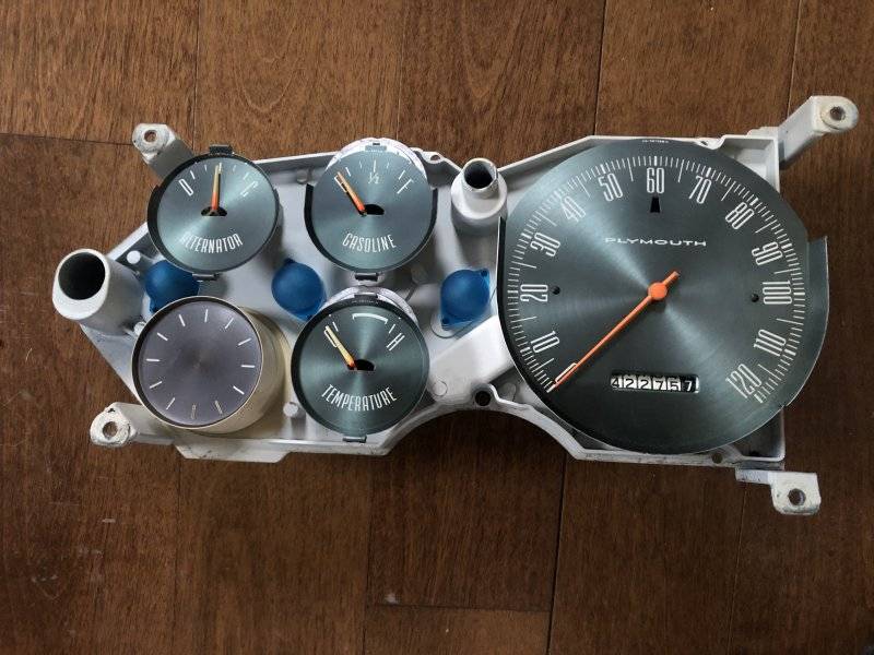

Hello all,
I have an instrument cluster for my 1962 Plymouth Savoy apart and a few of the needles could use a repaint.
Does anyone have any tips on the correct orange paint for these gauges?
1FBFA4CD-F8DD-4F3D-A672-D4D5F6244707.jpeg34A0A971-8AE7-424D-8792-20748661042C.jpeg6C70491C-6430-41A2-8B43-B27E5E16B6BF.jpeg

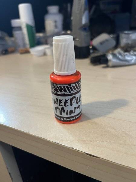

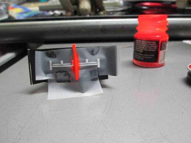

I know you can find some orange needle paint on feebay. I hope someone with experience using it can chime in.
I used some of the escam paint for a needle that needed it. Looks ok to me. I don't think there is a color code for needle paint.
I see the Sharpie F4R/T posted is paint, not ink. Those are at any office store

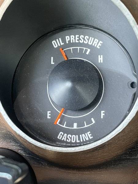

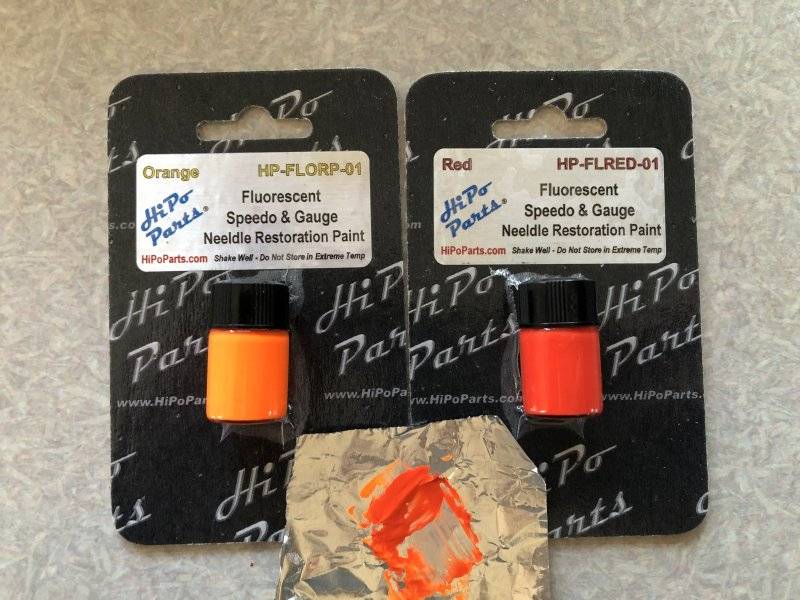

Thanks to everyone who weighed in! There are no good hobby stores close by me that I know about so I just ordered I mini bottle each of:
- HiPo Parts HP-FLORP-01
- HiPo Parts HP-FLRED-01

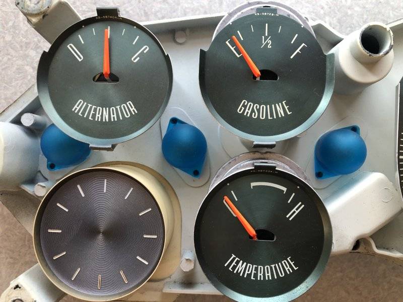

The orange seemed to orange and the red seemed to red so I wanted something in the middle, so I just took a few drops of each mixed them on a piece of tinfoil and that ended up working pretty good

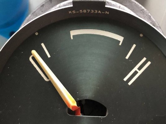

Before

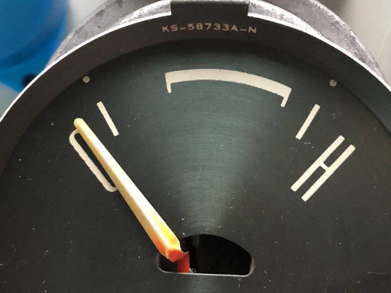

After
