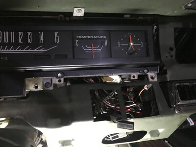

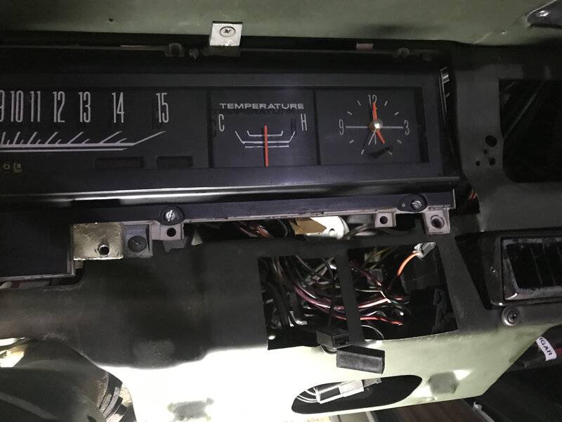

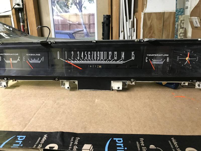

sooo.... Testers Fluorescent Orange, Dupli-Color Low Gloss Black (to paint the gauge faces) and some Sharpie Oil-Based White paint markers for the hash marks and it doesn't look bad at all. Best part is that they work. I need to get under the car and figure out why I had to ground the fuel sending wire to get the gauge to move, but otherwise I'm satisfied.
I'm probably going to send my original burnt up gauges to thegaugedoc.com for repair. I only painted up the temp/fuel gauges I swapped in from a cluster I had in storage.

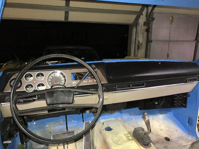

I used them on the gauges in a 74 Ramcharger and they were fantastic and still look good a few years later. I did a ton of searching for a set for the 68-70 B-Body standard gauges and none exist in any color other than white.
