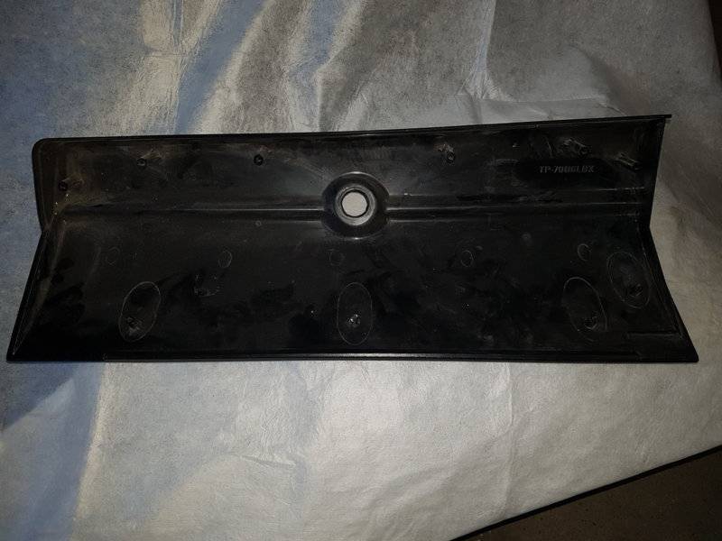

Good morning all. I have a question regarding the plastic part of a glove box door I bought off ebay for my 1970 Plymouth Satellite. I've got it and it doesnt match up to the metal part. The screw holes will match but the latch wont fit, or if I match up the latch opening, the screws dont fit. The only part number on the plastic part is:
TP-70BGLBX
I ran this number on moparts and Google and came up empty. I assumed it to mean 1970 b body glovebox, but possibly it means 1970 black glove box. Either way, it doesnt fit. I would just like to know what it does fit so I can try and sell it and recoup some cash to find another one that fits. Front and back photos below. Thanks for the help. As usual.

how far off is the latch hole,cant make it work? sound like you bought a repop.did you try to contact the seller on ebay?hope someone call help you out,good luck.
My guess
Rallye dash glove door different from standard dash door on 70 b models?
I do know for sure that the ashtrays are different
Yes, rallye glove boxes and the latches are different than the standard units. Rallye must be like RR, GTX, or Superbird.
