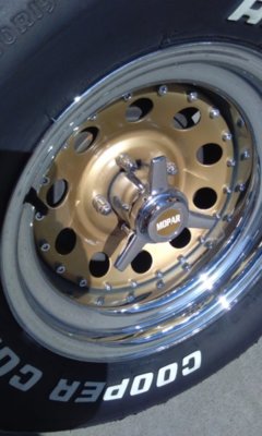

Remember those great Gold Modular wheels from the older days? They are no longer for sale but you can make your own. Buy US Wheel Series 94 Black in the size you want. Knock out the fake bolts from behind, about 25 of them. Put tape on the Chrome rim. Sand the black with 360 Wet paper just to remove shine of the black. Spray etching primer, then Gold engine paint (Or the color you want), then finish with Clear lacquer spray paint. Tap the 25 fake bolts back in. Be careful not to hit the painted areas. You can add a spinner.View attachment 887273 The center spinner is Gorilla 73506 3 inch center, and you can add a color center decal using eDecals.com 1.5 inch and add your color and script. Mine says MOPAR in white and gold decal. You can put ASPEN, VOLARE or other.
