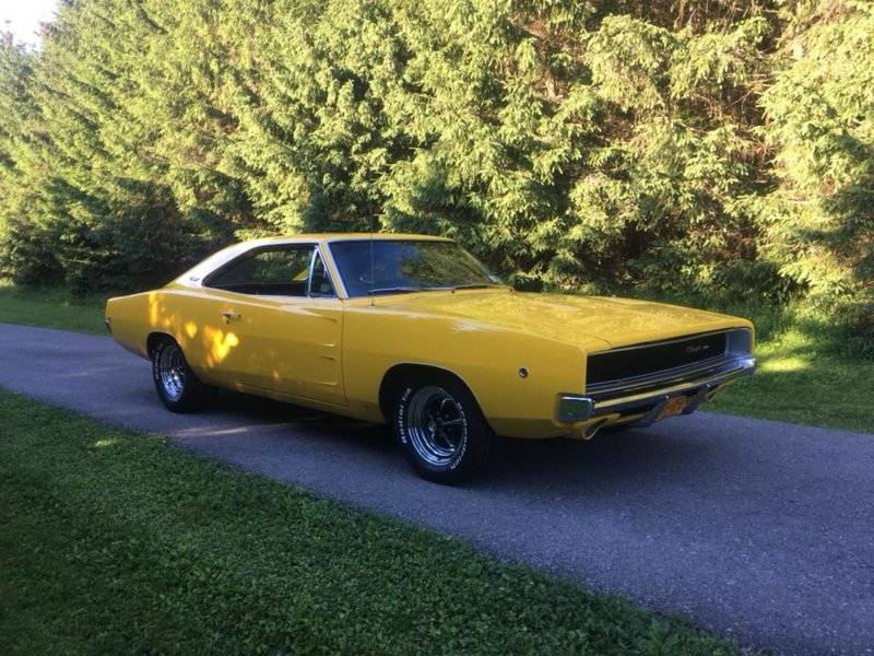

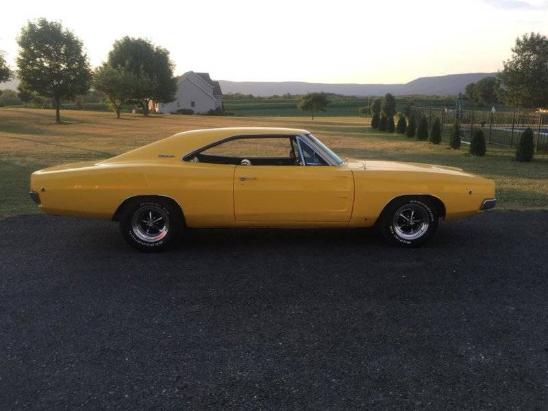

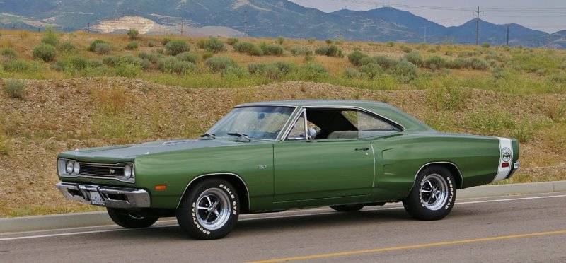

Just posted on another post.....It's my Charger but same concept. Fronts are 235/60/15 on 15x7 wheels and rears are 275/60/15 on 15x8's.

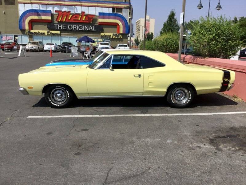

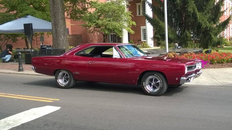

225/70 14 front 6” rims. 295/50 15 rear 8” rims. 69 Coronet.
Wheels are 72 Vintage.

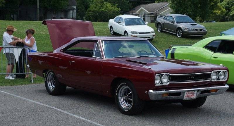

15x7 wheels all around, with 235/60 tires on the front and 255/60 on the rear is what I run on my '69 Bee.

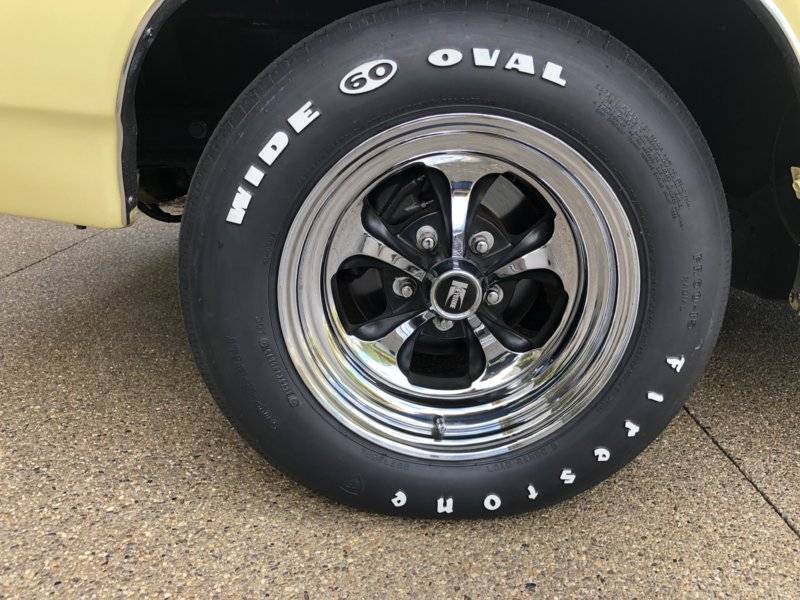

The Magnum 500 wheels are 15 x 7 ( with a 4 .25 backspace ) and 15 x 8 ( with a 4.5 backspace ).
These work well on the B and E bodies.
