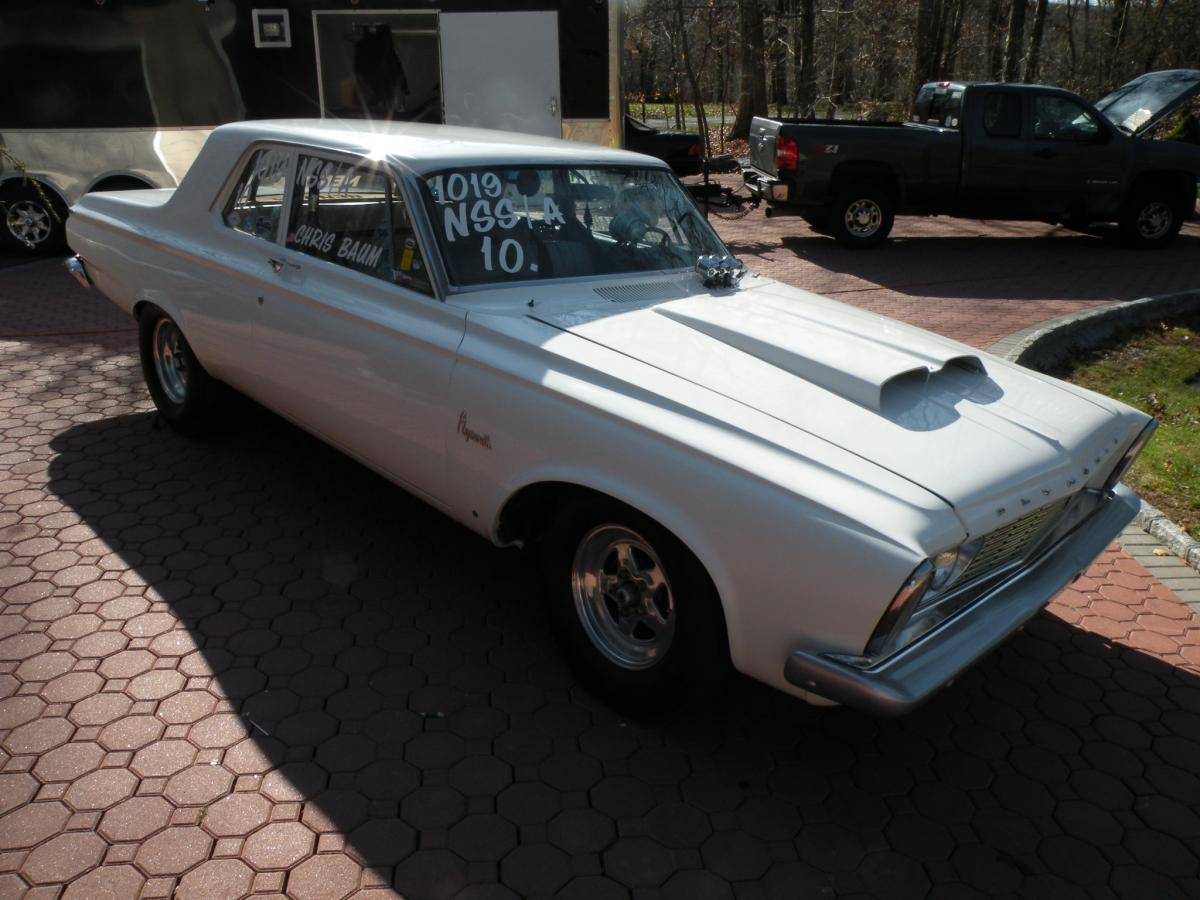

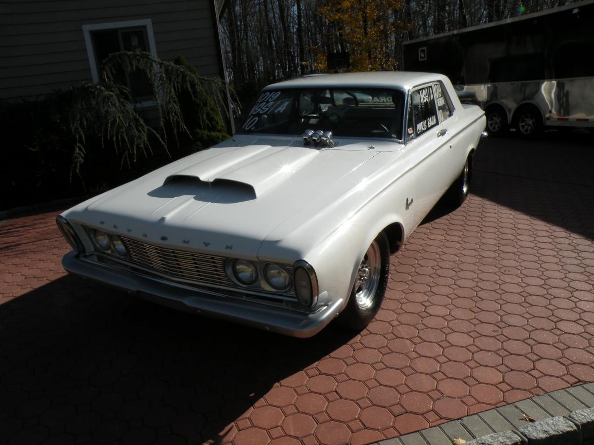

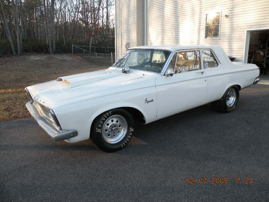

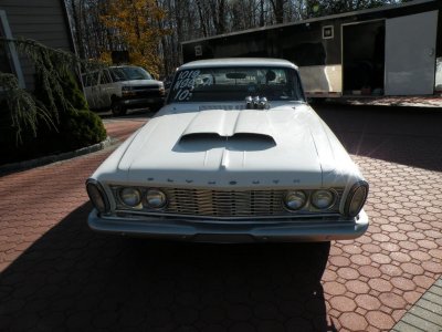

Well lets see what others say but I was told 3" from the back edge of hood, and thats what I did.
As far as the hole I used an electric saber saw with a good metal blade and had no problems.
Lay it out...........look at it..............think about it for a while.........look at it some more........go over measurements again...................look at it............and then cut. LOL
Oh and I went about 1 1/2" bigger than air cleaner I think.
here a few pics to help.

I think the hood scoop is 1.5" off the back lip of the hood IIRC.
3" is too much.
Not sure of the exact measurement of my scoop but mine isn't 3". It is more like 1 1/4" - 1 1/2". It isn't very much.
