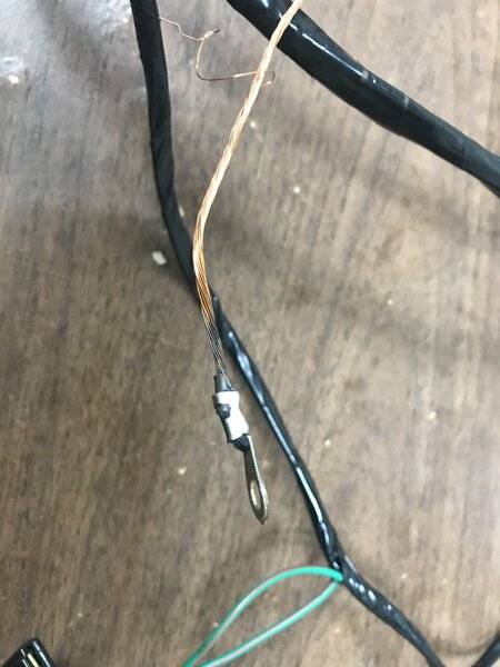

Working on a customer's car, 67 charger 383 4spd..mopar electronic ignition conversion.. would not start, crank but no spark. Verified ignition voltage at the ballast and positive terminal on coil. Verified reluctor gap...verified resistance through the distributor pickup....verified cranking voltage at the coil..everything seemed like it should, swapped coil and ecu but still no spark. After several hours of poking around and parts swapping it briefly fired up then shut down....again no spark....at this point I'm absolutely stumped....had one buddy holding a test light on the negative terminal of the coil looking for ground pulse, another buddy wiggling the harness while I was cranking....all of a sudden tiny sparks camw from the crimped ring terminal on the negative post of the coil....wiggling that wire at the ring terminal would result in intermittent start and stalls....cut off the terminal and crimped my own ring terminal on and BAM it fires up every time now! A ******* 50+ yr old crimp wooped my butt!....had enough connection to give me a good voltage reading with key on but not enough to pulse ground from the ecu to allow coil discharge...that was tough one for sure!!

This was the positive side of the coil on a ten year old reproduction wiring harness
