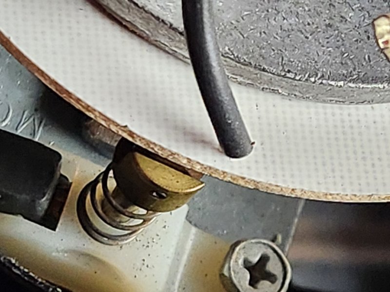

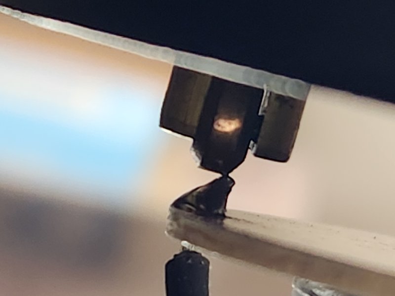

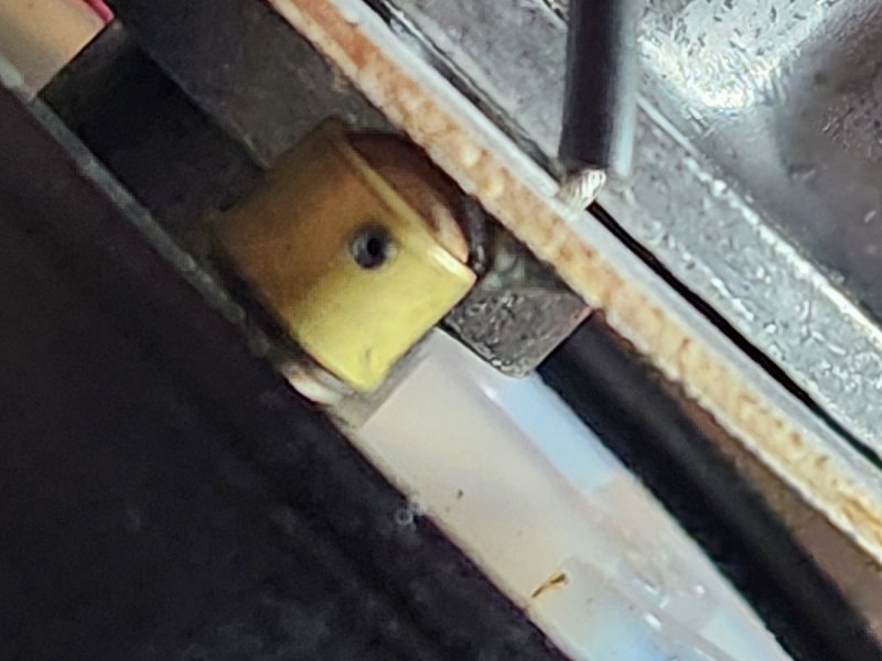

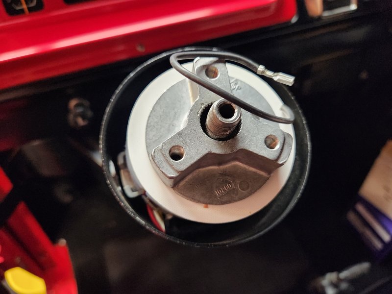

I know that feeling. It took two attempts to get the right one for my A100.
First one I got was a 3196, then ended up with a 4315 which is close enough - except the wire for the horn is soldered (soddamised) on the wrong side of the contact disc. I was able to relocate it - and leave appropriate feedback on Summit Racing. :rolleyes:
