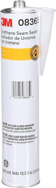

I use 3M Urethane seam sealer. 08367 is Black in color, but it comes in a beige. You can get it locally at NAPA
and it uses a regular caulking gun. 08365 is beige.

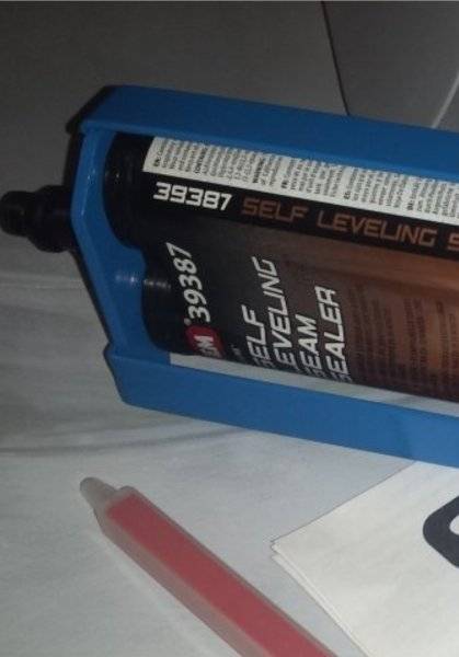

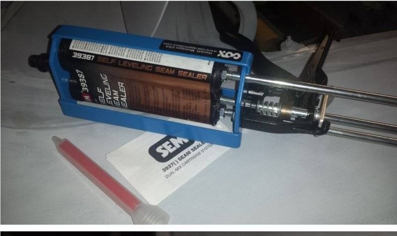

I used SEM 39387 self leveling seam sealer on my GTX. Works great. It requires a special gun but I can send you my gun to use if you go this route.

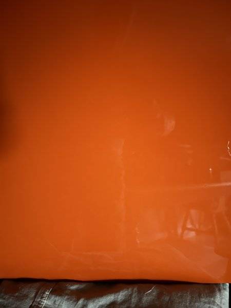

Test panel one. 2ft x 2ft over white. Just a quick spray out to look at the color. Wanda “Tangerine Orange” base 3 coats. This is very close to the Chrysler 999 special order orange.
Covered with some leftover clear 2 coats I had laying around for a few years lol. A little orange peel, trash and solvent pop. So far I love this color. Will do one more color sample before my final choice. Plan on using SPI clear with it.
Nice Color!
