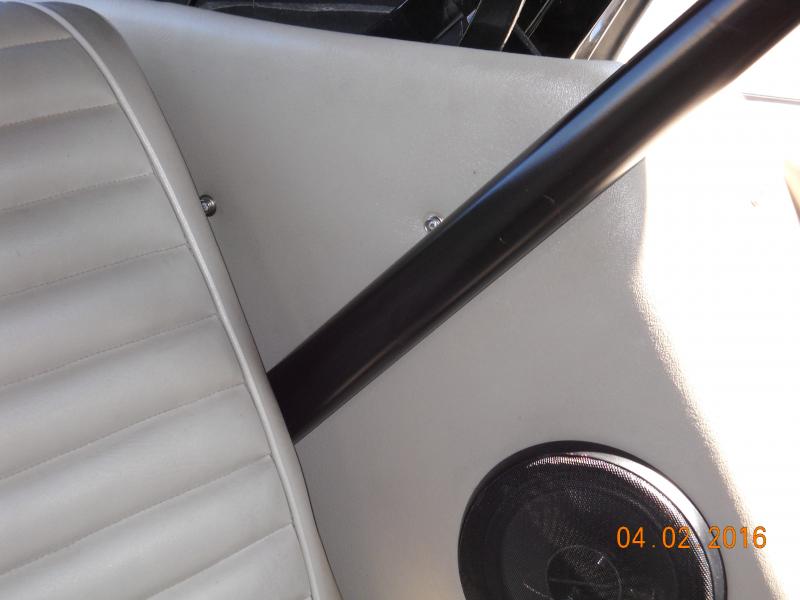

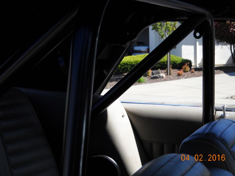

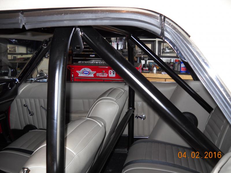

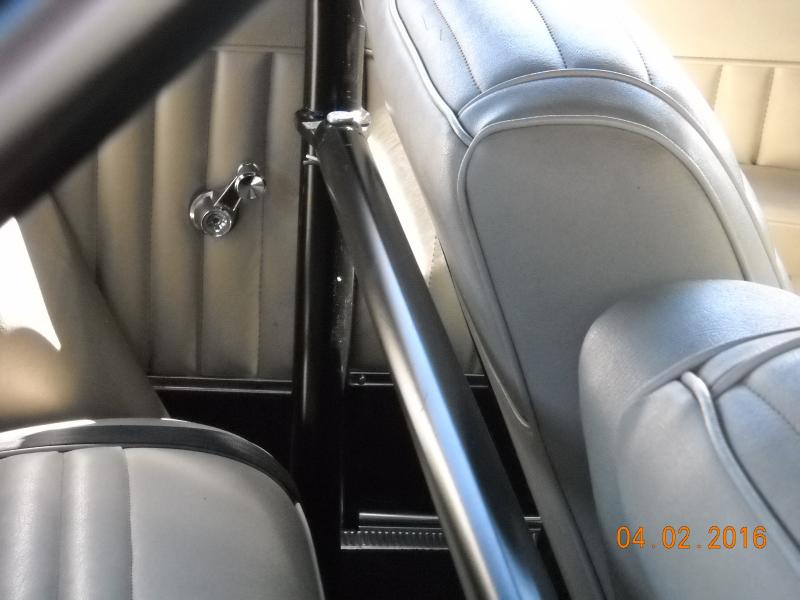

Just did this...
Just installed a 4 point roll bar in my 63 Fury convertible. It is an Alston kit with custom back bars to allow the use of the backseat. I also used their removable shoulder harness bar. This is strictly a street car and I am going to install a 3 point seatbelt first. Wanted the option to use a harness someday.

Thanks Dave. The bar and the interior look awesome. Are you figuring you'd have to change seats to put in racing belts or have you not gotten that far w your plans? What are the little tabs at the top with a small hole drilled in them?
I guess w those square-top seats the belts could go over the top like they do in the early Mustangs...
Thank you. The tabs are for the retractable 3 point seatbelts which I haven't installed yet. If I ever decide to use harnesses, they will just come over the top of the seat back. The bench is staying.
