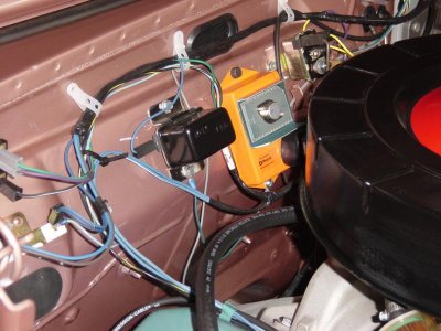

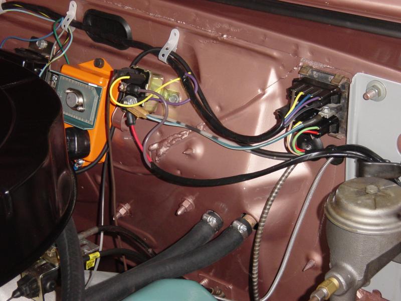

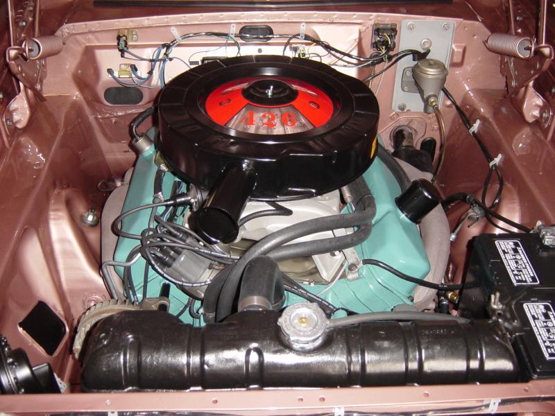

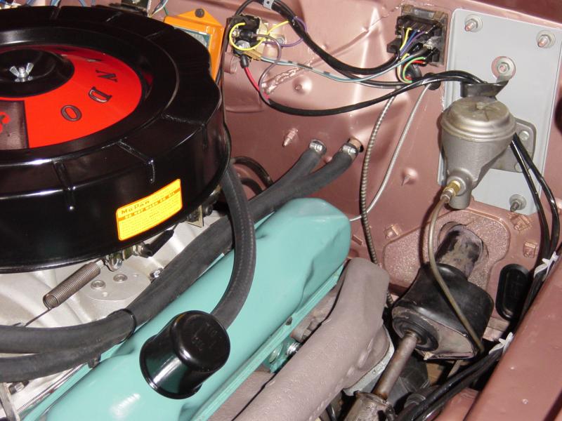

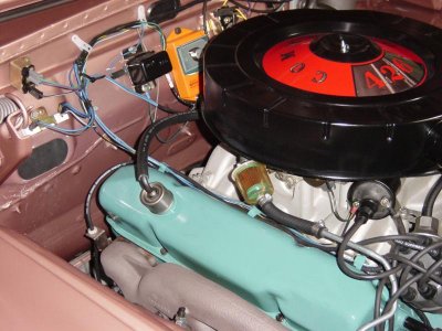

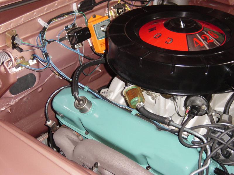

Hopefully the attached photos of my 65 Belvedere will show you the routing of the wiring harnesses, the factory location of the regulator and all the other components on your 65 Satellite.

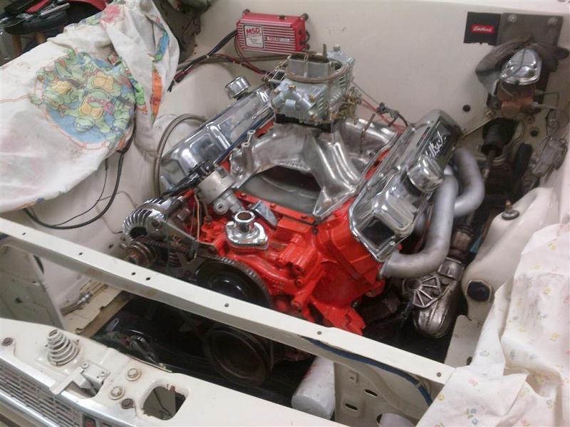

Here is my firewall
1965 satillite
I don't see a ground strap on the motor to the firewall. I just went through this with mine no lights at all until I installed the ground strap from the head to firewall. Good luck and nice car. Lenny

i think your po was a bit confused.the only thing you would remove to install msd ignition is the ballast resistor.the voltage regulator has to do with charging and maintaining a constant voltage.you would be best served,since there is much modification,by getting a wiring diagram and going through step by step.all depends on your electrical knowledge.
