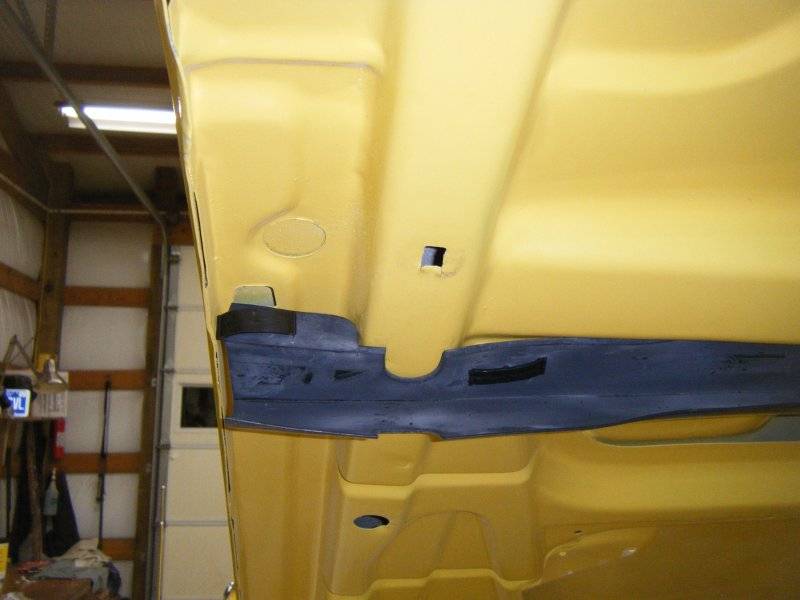

can anybody tell me what these are?
thanks

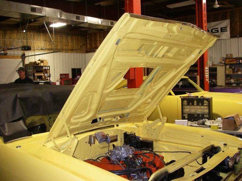

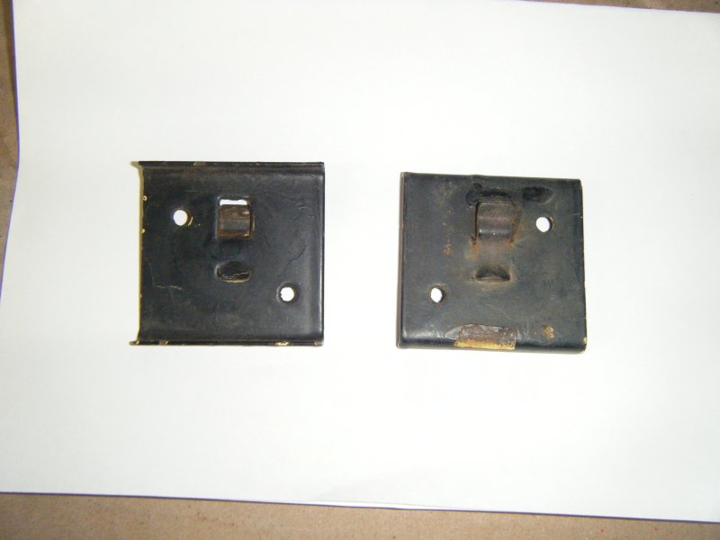

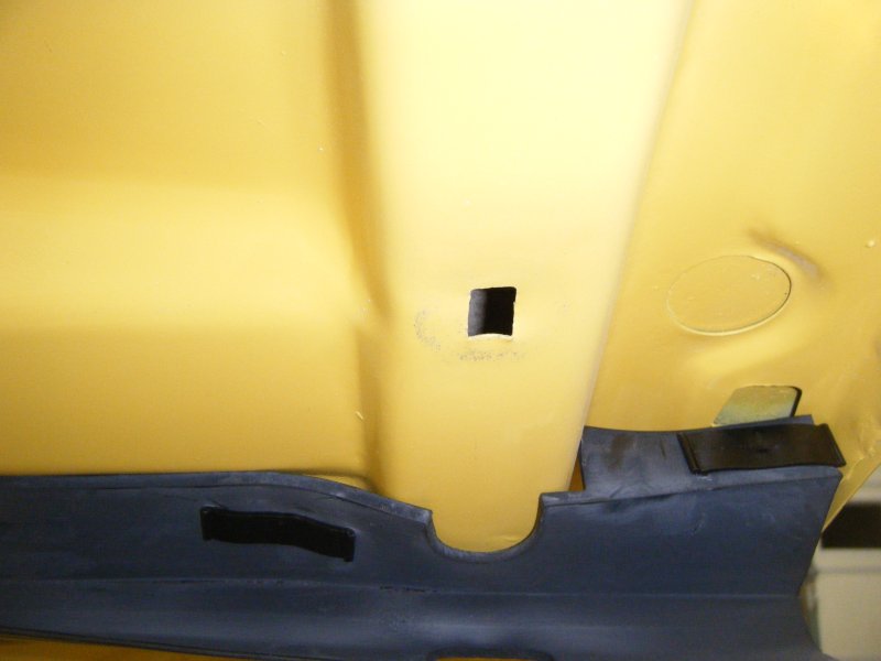

They go on each side of the hood and are the hood bumper reinforcements... What these hit when closed..
This is the best picture that I have. If you can enlarge it, you should be able to see the orientation of the plates. This is on a B body, but I would imagine E body is the same. The plates just clip in place. The clips on the plates clip into the holes that you are showing in your picture.
