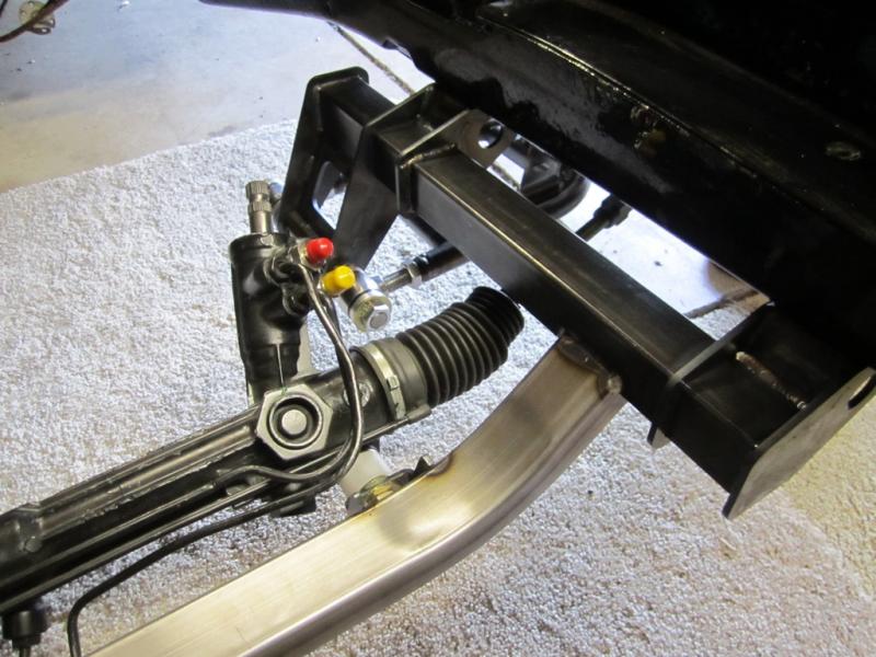

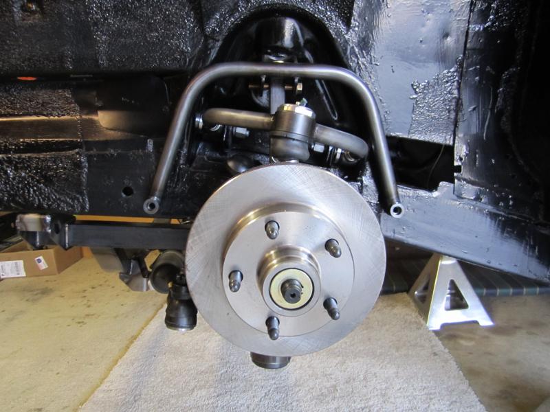

HDK narrow B-body prototype w/power steering - trial fit in '63 Fury.
HDK B-E 1 001.jpgHDK B-E 1 013.jpgHDK B-E 1 014.jpgHDK B-E 1 009.jpgHDK B-E 1 010.jpgHDK B-E 1 007.jpg

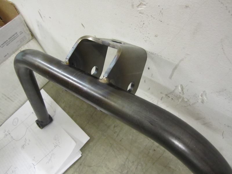

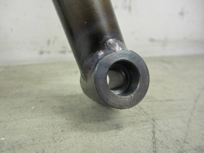

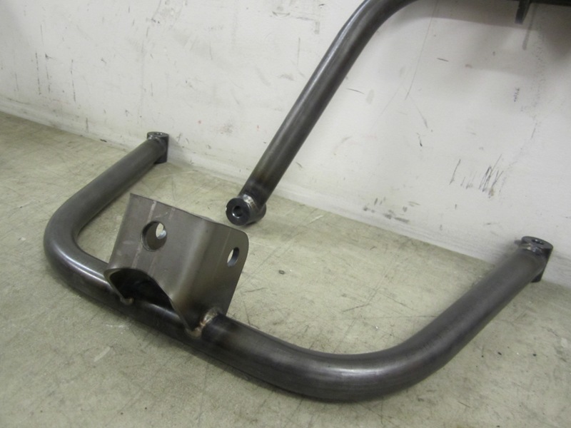

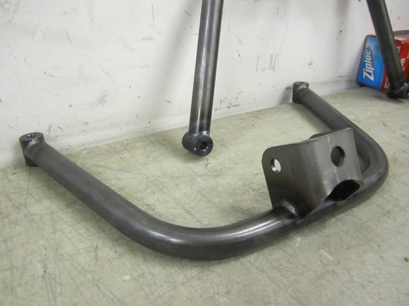

HDK B-E body upper coil over shock support brace detail photos.
Upper part locates in the stock upper shock absorber mounting hole and the lower
mounts go through the stock frame with inner sleeves to prevent crushing and have
dedicated allen head mounting bolt receptacles. Shock mounting holes can be seen
at the top. When this is all mounted and tightened it makes a very stiff triangulation.
Brown Duster 7 013.JPGBrown Duster 7 014.JPGBrown Duster 7 015.JPGBrown Duster 7 016.JPGBrown Duster 7 018.JPG
Normally they use Willwood Pro brakes and spindles but there are a lot of less expensive
alternatives as the spindles are Mustang II based and the choices are innumerable.
This Particular '63 is under construction and is not necessarily going to use this suspension. It
is owned by the K-frame builder's brother and was used for a trial fit because it was available.
