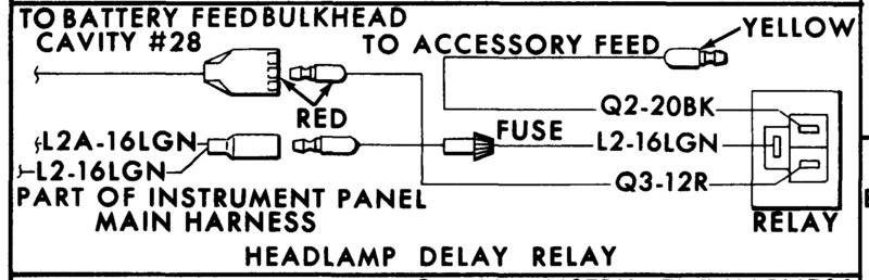

I am interested in installing a headlight delay relay in my 73 Charger the relay is available I am not to sure if the car is pre wired for this option, or a need a harness. The Polaras came with this feature I think it may be easy to do. Does anyone have any pics or info ?
Thanks
