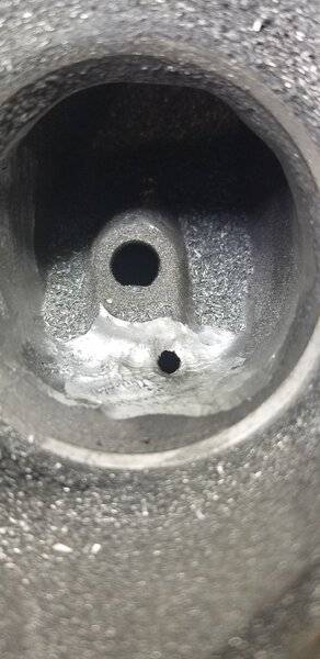

Know how far you can go
to far &**& #&*#$
What kind of head is that? sure isn't a 906 or 452!Dang!
Well, now you have a head with seven other ports you can practice your technique on, and one you can saw in half to see where the water is.
Yup.. Metal cutting Bandsaw Through a couple ports... Grind away, can't hurt it anymore than it already is.... Funny, I tend to be careful around the back side of the guide but I hog the throat a bunch...
It went through quick I didn't remove much material at all. I only had 2 more ports to go and I would have been done with both heads.

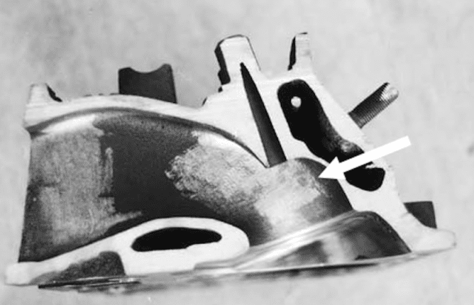

Steve Dullich published an article about porting Big Block Mopar heads... Amongst the pictures was this one of a sawed apart 906 which I find very informative.... Look at the back side of the guide... There's water on the short side too but not nearly so close....
I looked at all the maps of heads I could find on other sites. Some were hand drawn and some were actual cut always. Like I said they are just 902 heads and I really haven't tried yet to find a replacement.
