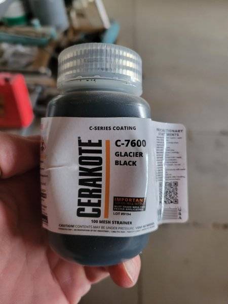

I used Cerakote on the hotside of my turbo on my jet boat. The hotside gets extremely hot. It holds up very well. Proper prep n follow instructions.
