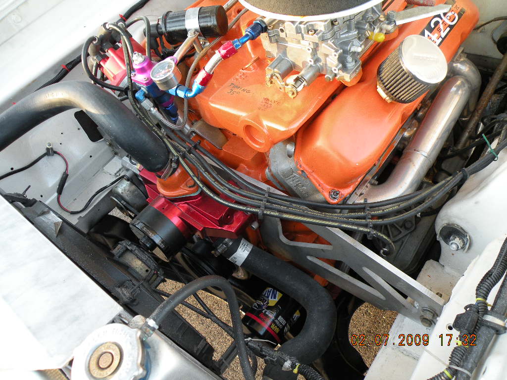

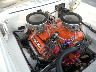

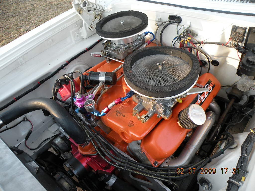

I got 2 sets of headers that would fit your car if interested. Hookers super comps.
