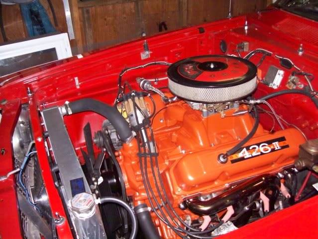

These are the 2" TTI's I have on my 440 RB block in my 63. They fit the RB block good and I thought they would fit the low block but I am not sure if everything will clear on the lowblock. Ron

Thanks for the kind words. My point was just that of what you said. Will the 2" TTI headers I have with the RB block work on your B block ? We need to look under my car or a early B with the 2" TTI's and see if they look like they will fit dropped down 3/4". You might try over at Moparts in the Race section as they have alot of racers over there who should know if the same headers I use will work on you B block. Good luck , Ron
