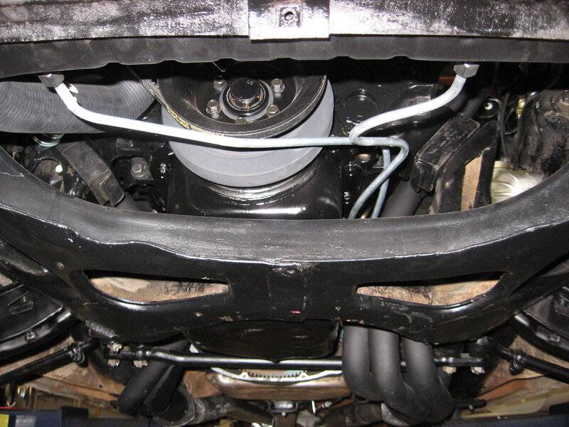

Hi, thanks all.. does the driver side come in two pieces ? How do you get it around the steering linkage?
OH is the Charger the same body style and under hood steering set up??
tim
The Summit /Jegs are not 2 pieces on either side.
75 Charger and the Plymouth Fury 2 door share the same body style and underside.
You will have to disconnect the steering on the driverside (see photo)
More expensive and top quality such as TTI go above the steering linkage.
See photo
