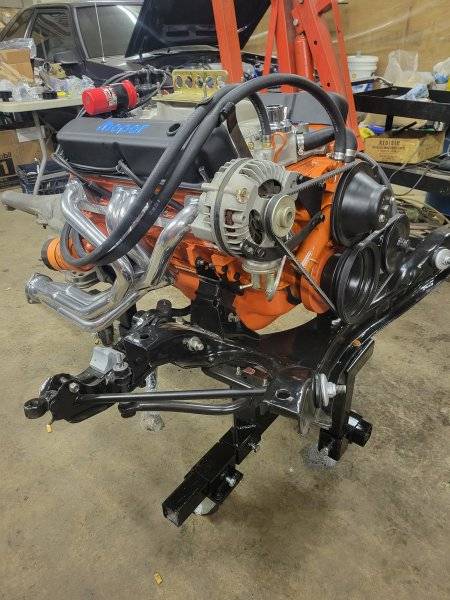

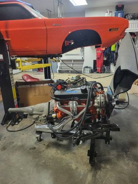

My 73 Road Runner with a 340 did not need one.

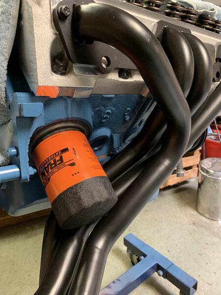

I was looking for a clearer photo. This all I got.
Another photo. Summit Racing Headers.
Out of all my pics, not 1 great shot of the filter lol

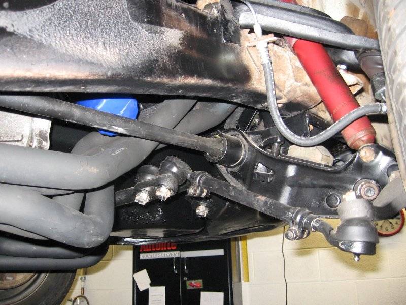

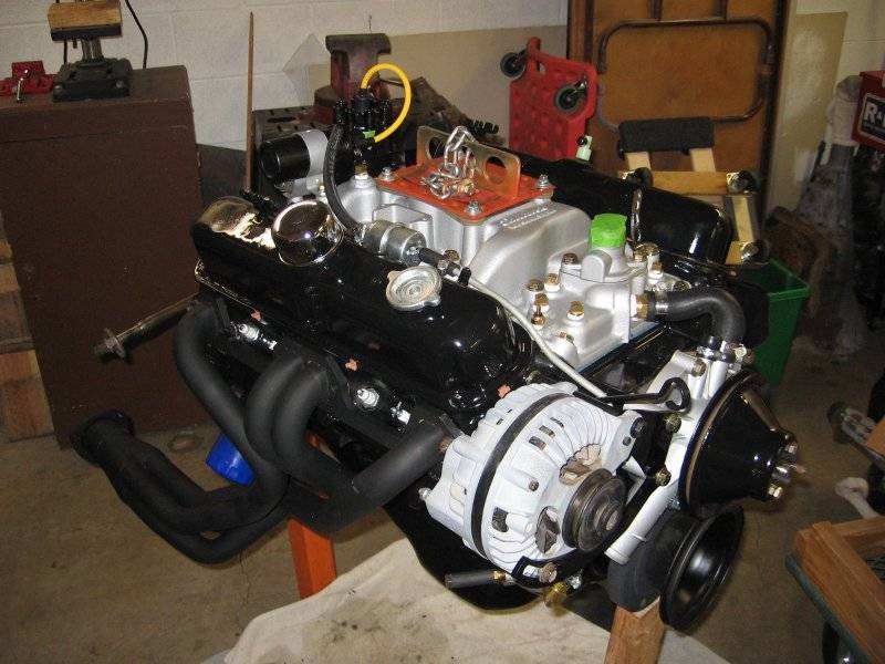

No oil filter adapter needed with my 340 and TTI longtube headers.
Mine is a poly with TTI's no adapter needed, just the short filter.

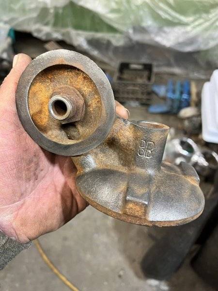

Do you need the oil adapter for the filter if you run headers on a 318? I believe you have to if running 340 exhaust manifolds what about headers? View attachment 1603751
That's for a 340 :poke:
