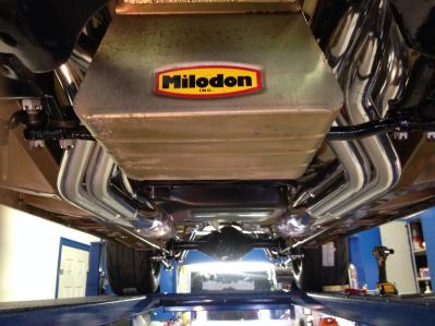

TTI's, for sure. They are the best fitting header that I have ever installed on any car, period. I have the 2" tube. image.jpgimage.jpg

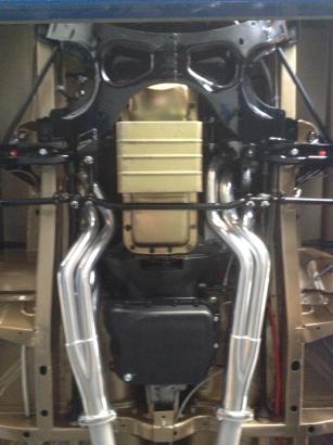

My '65 Coronet with 2" TTI headers,,3" TTI exhaust with X pipes takes a different set of collectors.
System fits fantastic but the parking brake cable is now a problem,,,,,,I haven't addressed it yet

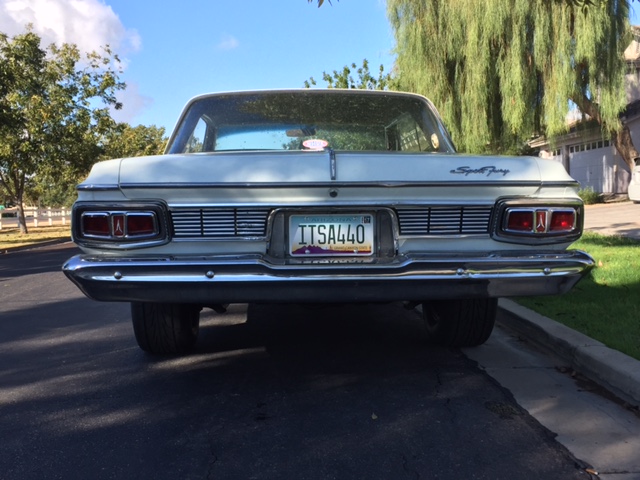

Crusty
Its not a factory color, infact, the body work is something Im not looking forward to - Its a fifty footer for sure. The original color is a gorgeous turquoise color... not sure the name. There evidence of it in the trunk.
